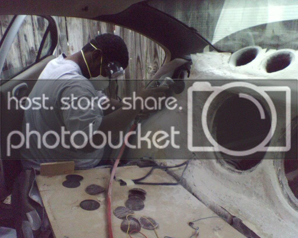

Not too much was done after this besides some slight paint and then I'm going to rip it out soon. It's tuned to 30hz, supposedly. It did pretty decent on the meter when it came to tones (i think the last testing i did was in MECA, 149.6 on the headrest, i think it was and I did 150.2 legal, like brandon described with 4 hifonics 1606ds, not the sundowns.) it wasn't the best but music was quite impressive. Especially 8Ball & MJG - Hickory Dickory Dock.
Hey thats me. horrible picture tho
