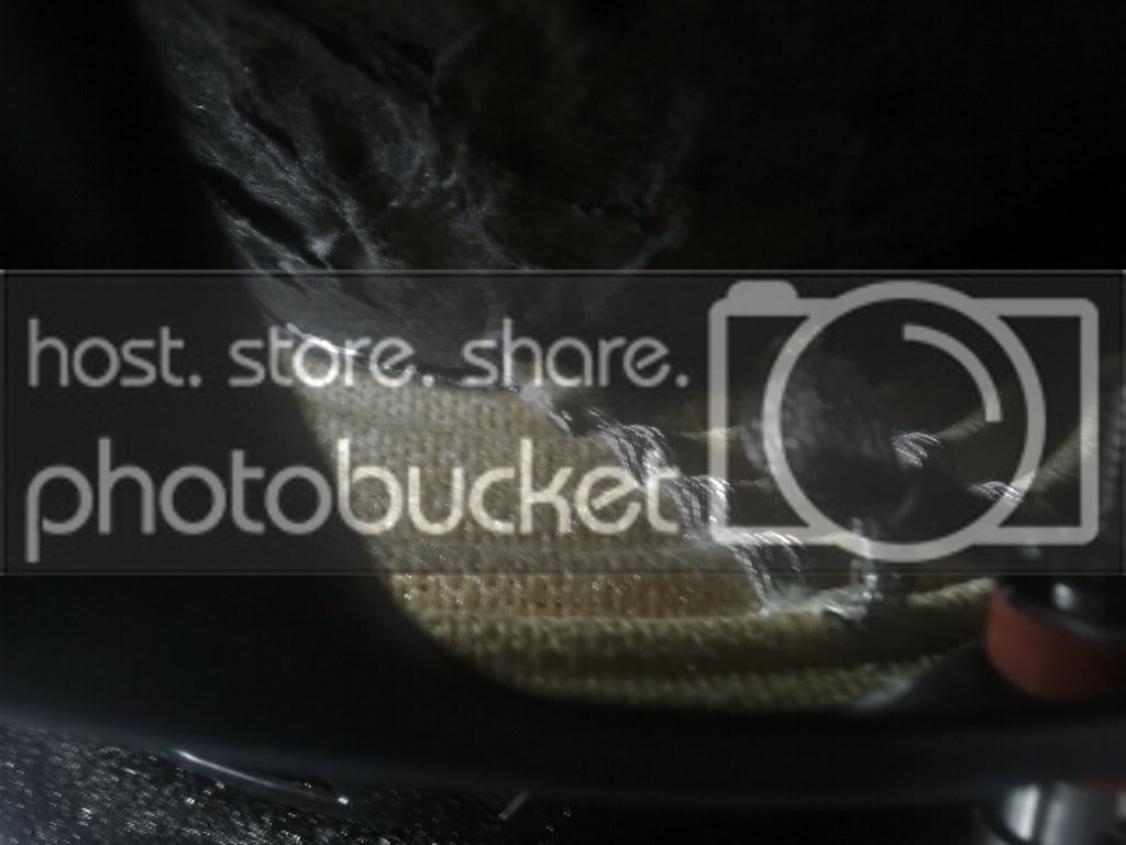

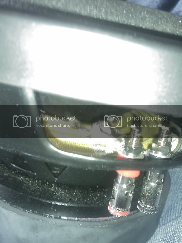

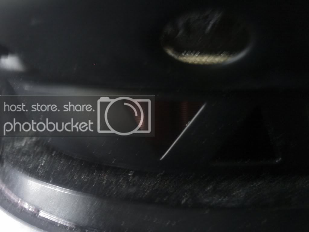

I was just playing them like normally everyday, nothing super loud or anything. Yesterday i didnt even drive my car, and today when i get in my car, i notice the subs are quieter than normal. I still dont turn it all the way up, just playing normal. Then i hear the subs cut in and out sometimes. When i get home, i look at my box only to find out that only one sub is working. I take both of them out, one of them doesnt read any ohms, and the other reads 30+ ohms and keeps changing. This sucks, what could've happened?
Coils look fine, no burn marks or anything. On the one that doesnt read anything, there's a burn mark on the + tinsel.

hmm, any scratching when you push down on the cone?
None //content.invisioncic.com/y282845/emoticons/frown.gif.a3531fa0534503350665a1e957861287.gif
Right before i took them out, they werent playing, but when i pushed on the cone of the one that reads something, it would play and give out this nasty sound like it was bottoming out (it wasnt bottoming out since the volume was really really low)
