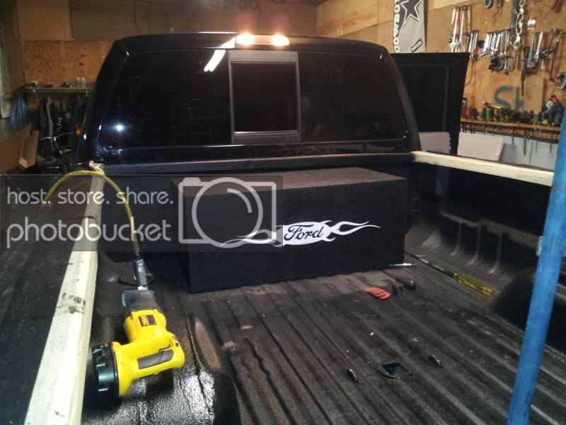

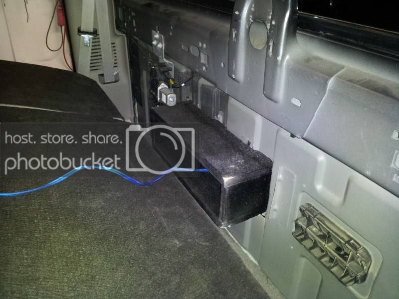

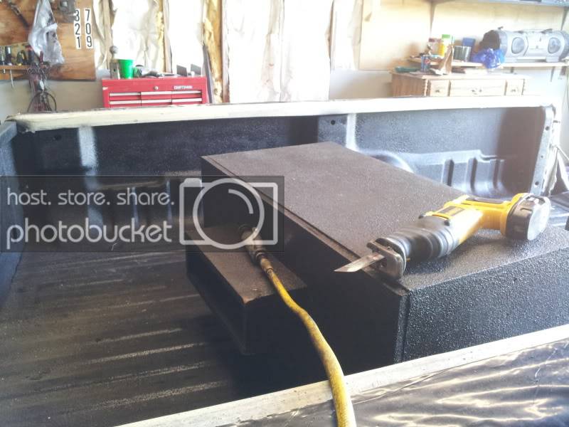

I had a few people PM me asking why I needed/wanted more info on this situation. Well here are the pics and then you will know why lol.
Looks like a small 4th order enclosure and I sent an email asking if I could get more measurements so we can figure out what was built and how to fix the issue.
OP- If you have not messed with the amp yet, could you get some pics of how the settings are adjusted on it? Assuming the enclosure is decently designed I'm betting that may be your issue.
That box looks no different in size than a standard dual 12 pre-fab, which never hit the low lows.
The enclosure is just over 5ft3 gross so it is much larger then a prefab enclosure. Just designed/built wrong for what the OP wanted. The OP has something big in the works though.
