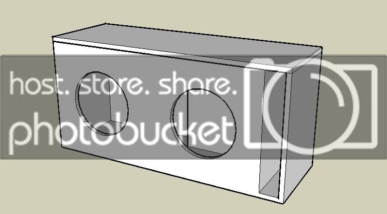

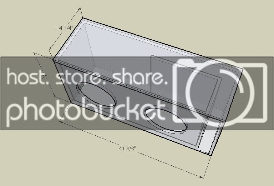

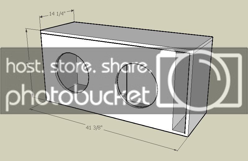

ok lets try this again and see if i get a better response.
could you design me a box for 2 12" type r's. my max dimensions are 50w x 16d x 20h i would like to keep it around 4.5 or 5 cubes total because thats what i have heard they do the best at. i would like it to be vented. it goins into a 96 dodge dakota ext cab pickup. i have heard that in a truck subs and port forward works best?? maybe you know a configuration that is better. if you know a better configuration than thats how i woudl like it. i would like the tuning to be between 30-34 because i like the lows to hit really hard. i listen to alot of rap so i want alot of bass. also i would like to keep 50" width as minimal as possible and the 16" depth as minimal as possible to leave more leg room. also i will be running 600 watts to each sub so 1200 total. in the long run i might up it to 1000 each. but not anytime soon. let me know if u have any questions and what not.
Thanks Matt
