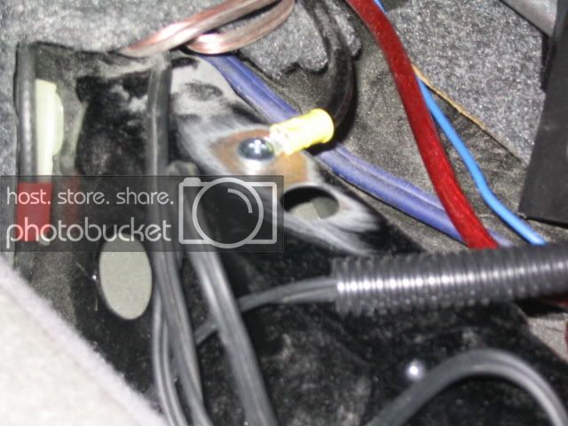

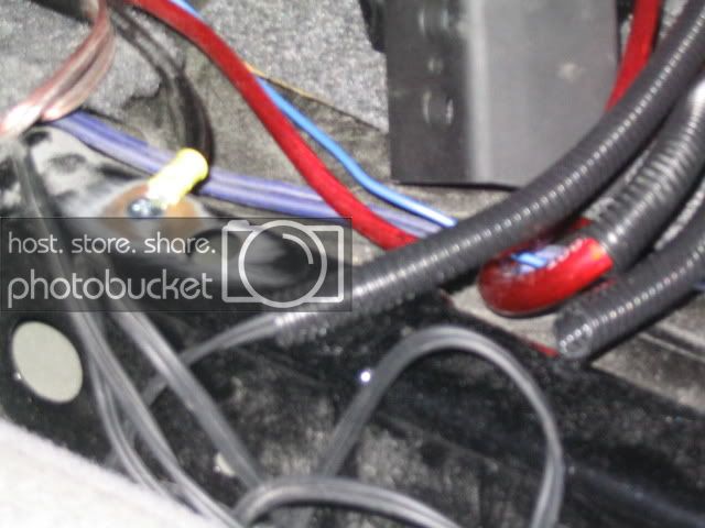

Hi, I have had my system for about 6 months this is what I have
MTX thunder 6000 10 inch ( 2x)
Phoenix Gold ZR6.5Comp
Alpine Type S Rear
Phoenix Gold Xeonen 600.1 power the subs
Phoenix Gold R2.5.2 250watt 2 channel to power the fronts
Alpine CDA 9856
4 Gauge Wire Kit

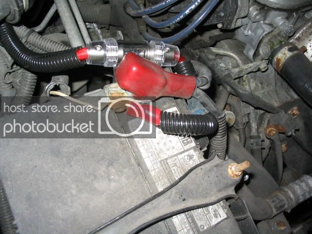

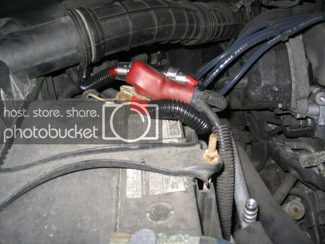

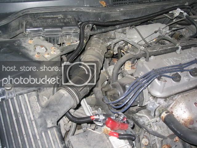

I have a 60A fuse running up front by the battery. All of a sudden when I was running it loud as usual, the fuse blew for the first time. So I just thought maybe it was the song...
I went and got a couple more fuses just in case... I put one in, as I am turning up the juice in my system another one goes (not as nearly as loud as it was when I blew the first one..)
I will say this, whenever the bass hits the lights dim, the dashboard dims, the digital clock dims and all of that.
I have a 98 4dr 4cyl accord 2.3L.
The battery has been tested today at autozone.
It idles at 12.37v and revving at 2000RPMS for 14.04V
Also all together it has 3.7A.
Thats all the information I have... But I was just wondering what can I do to fix this, and whats the problem!?!? Its killing me I want to listen to my beautiful system!!!

My Xenon 600.1 Class D Amp is 60A Fuse
and my other amp is 20A Fuse
there all ran on the same line so does that make a difference?
I was thinking of going for a 80A Fuse... I don't want to go something to big and short something out, because I mean the 60A was doing fine all 6 months up until a couple days ago...
so why all of a sudden start just start blowing fuses right????

just see if a bigger fuse becuse the math is already there for you, you are pullin more than 60 amps from ur car with ur amp.
u will be wasting 50 bux for them to tell you your fuse was too small
