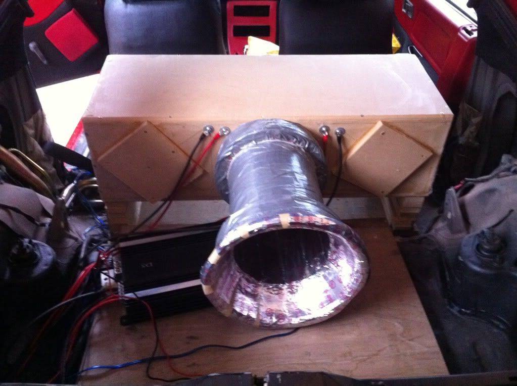

what are the specs on that box? what is it tuned to? what is you port size?
I don't recall exactly. I think it was 40x10x10? I just remember it was ~ 2 cubes gross. And it was a homemade 8.5" sonotube aero.

is that port inside the box at all or just outside the box??
That setup is ugly as sin, but Ive heard you know your stuff! Are the sq inches of those 4 subs equivalent to two 12's?
Basically. (4) 8's is like 200sq in. (2) 12's is 226. And ugly = loud.
All external. Its screwed on from the outside and the mounting side fits flush with the inside of the back panel.

Cool, you know someone that can design me a box similar to that that would peak around 52hz so I can bring the pain the next comp? I really want to surprise these guys and show what 8's can do
