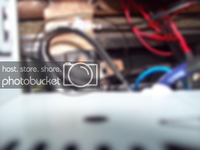

its that whole piece, dunno what its called you can see the metal, then the black part over-lapping it just under my ground, thats where their hitting up against

is it the loop that comes up behind the radio, or a full wall of metal?

and yeah its not exactly a full wall of metal, its this:
its what i circled in black
as for that pipe, i dont think i can cut into it
