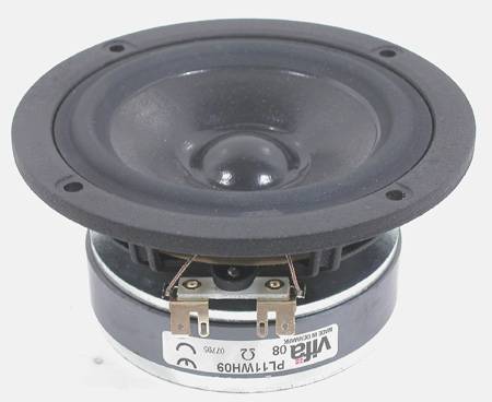

OK found another Vifa that looks really good based on specs.
Vifa PREMIUM LINE 4.5” mid-woofer
Nominal impedance [ohm] 4
Voice coil resistance [ohm] 3.0
Nominal power [W] 35
Short term max power [W] 140
Long term max power [W] 80
Operating power [W] 10
Sensitivity [dB] 89
Frequency range [Hz] 70-5000
Free air resonance [Hz] 67
Voice coil diameter [mm] 25
Voice coil height [mm] 10
Air gap height [mm] 4
Voice coil inductance [mH] 0.31
Eff. diaphragm Area [cm²] 58
Moving mass [g] 6.4
Magnet weight [g]/[oz] 415/14.6
Force factor [bl] 4.7
VAS [l] 4.25
Qms 1.80
Qes 0.36
Qts 0.30
They are $54.00 each.
