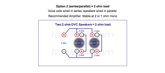

So I can either wire each sub’s coils in parallel to create 1 ohm each, then wire the subs in series to create a total of 2 ohm load. OR I can wire each sub’s coils in series to create 4 ohms each, then wire the subs in parallel to create a total of 2 ohm load.
Does it matter which way I go with?
2 ohm final.
