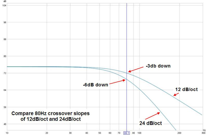

Slopes in general are how quickly the unwanted frequencies are filtered out. The steeper the slope, the less of the unwanted frequencies there are past the crossover point.
-12, or -18dB or whatever refer to how far down the intensity is per octave. So a -12dB slope LPF @ 80hz will be -12dB down at 80hz and -24dB down at 160hz.
