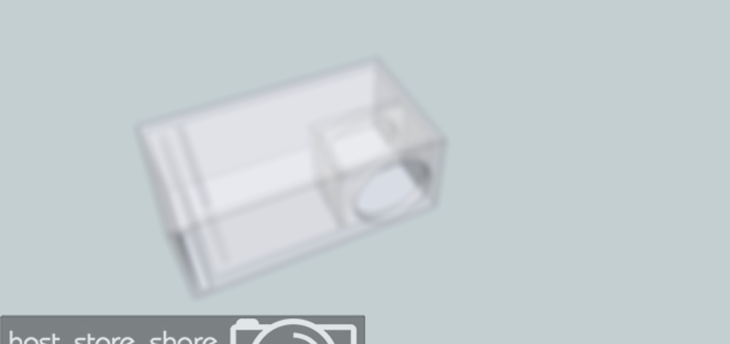

I found some t/s in winisd already. did you measure your trunk to see what fits? it would be much easier to draw it up then try to explain it.
These are the dimensions if you literally dropped the box straight down and then slid it all the way back it would fit.
H - 13"
L - 38"
W - 19"
Looking back, if my box was re-arranged a bit, I think it would fit...?
H - 17"
L - 39"
W - 16.5"
this is how you do it, unfortunately the height of your car doesn't allow that. would need 15'' high.
Is this a bandpass or still ported?
Smaller subs, sealed boxes, run a single, etc. You have multiple options.
I'm thinking 10's would be best? How much smaller would/could the box be?
it's isobaric, it uses the force of both subs to shrink the size of the enclosure. it's an old school SQ design.
How does it sound? Is that built specifically for my subs though? That's my whole issue with all these boxes. The one I have now is just a generic box and the one that I have built(but is too big) is ideal. Is the one you made in line with specs provided by ID?
