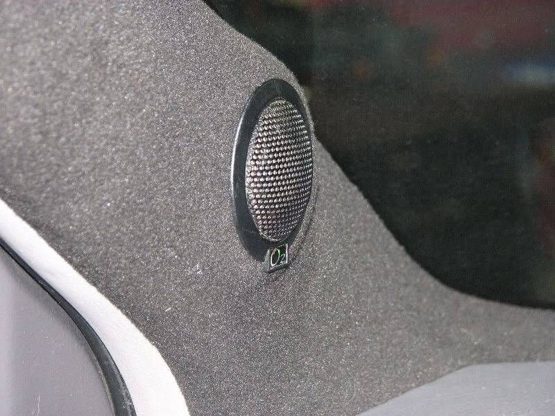

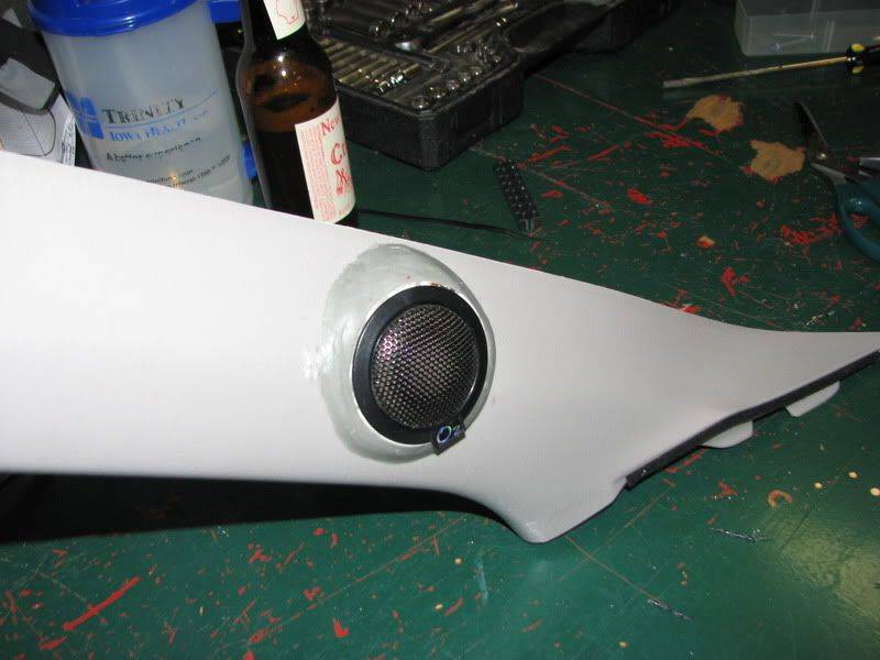

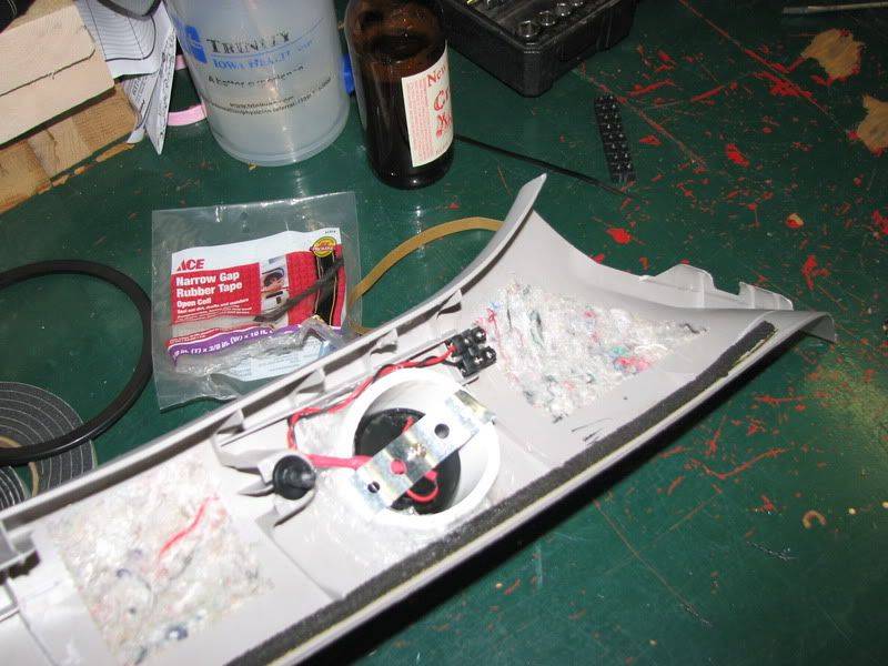

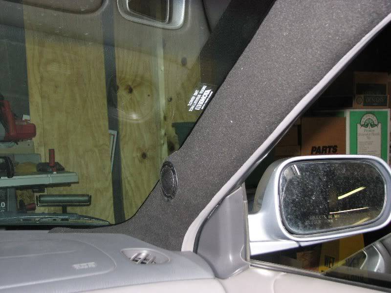

I made them with some PVC. Used a hole saw for the apillar, used modeling clay for the form, covered with fleece. Black so they were not conspicuous outside the car.
The plumbers strap is fine for back mounting. A terminal strip allows for removal.

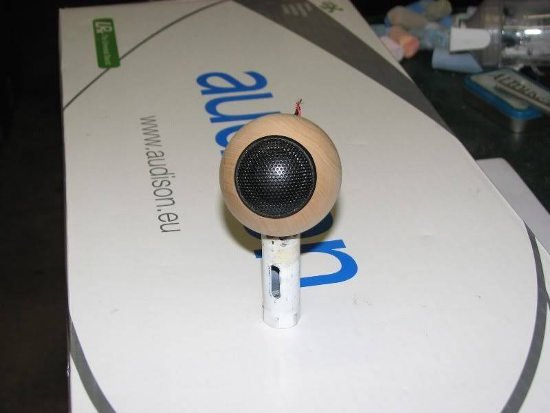

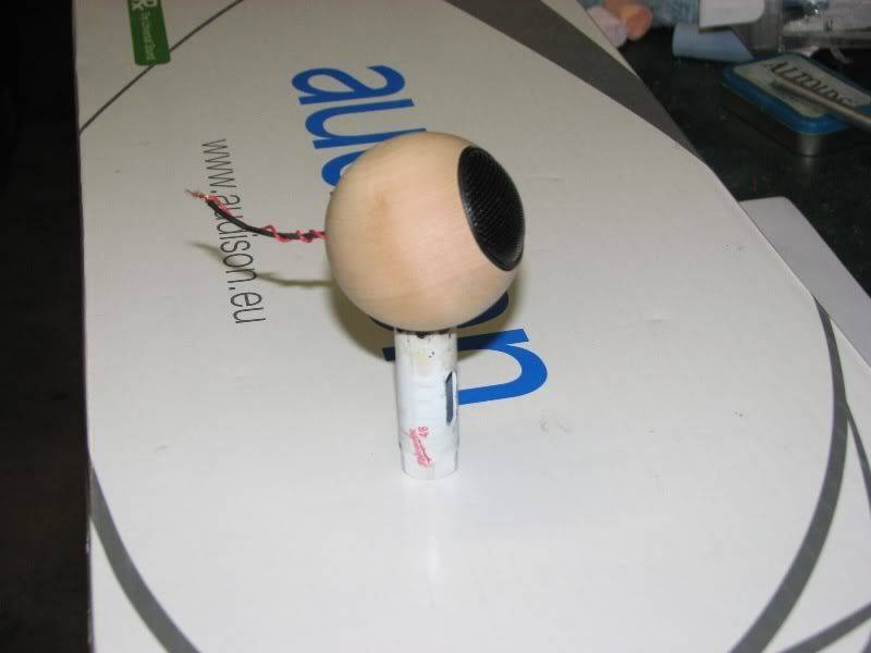

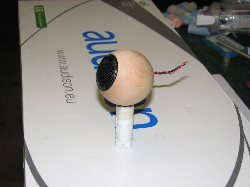

My newest plan is to use solid wood spheres to mount the tweeters off the apillar an inch or two. This is to smooth response by reducing diffraction. The loudspeaker design cookbook 7th Ed. covers this.
Here is my first one with a spare tweeter.
More details in my build log.

Those are nice reminds me of an eyeball but since most tweeters are pretty much sealed does it really help? I could see helping mids
