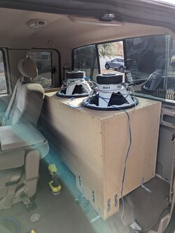

Everything looks and sounds good as of now, got to clean up the wiring

Not too mention making it easier for people to see i.e marking it for those people who like to steal. Those sliding windows are easy to open and steal from. Trust me I lost a system from my one truck even with a lock on the sliding window. You aren't gaining anything with them like that.
