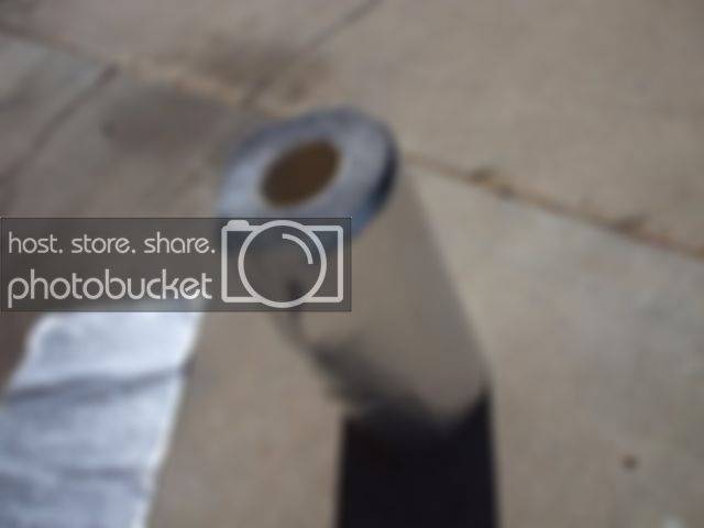

I used eDead V1SE2
Link:http://www.edesignaudio.com/product_info.php?cPath=1_24&products_id=52
I ordered 120 Sq ft of it cause i am gonna do my whole cab soon.

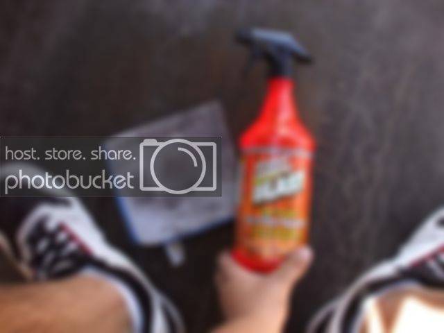

2.Somekind of degreaser *I like Greased Lightning BLAST*

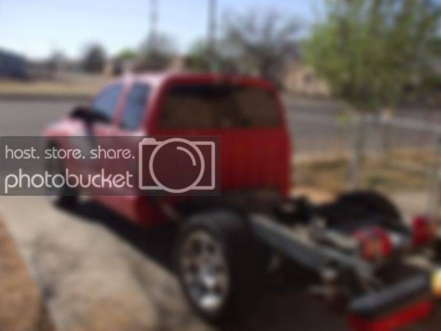

The Victim!!!
1998 Dodge Dakota Sport!
I am in the process of painting my truck at school. I shaved my emblems off and antenna. //content.invisioncic.com/y282845/emoticons/smile.gif.1ebc41e1811405b213edfc4622c41e27.gif

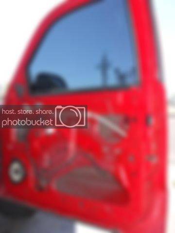

Step 1:

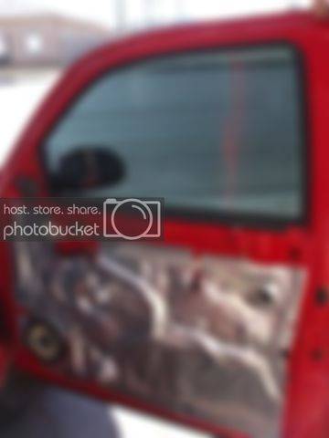

First you will remove the Door Panel, by removing the 4 screws on the door panel and pusing up. I circled
the screws in Green:
You will also need to take the harness off the window switches *if you have power locks and windows*
And the rod that is connected to the door handle.

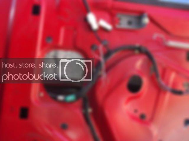

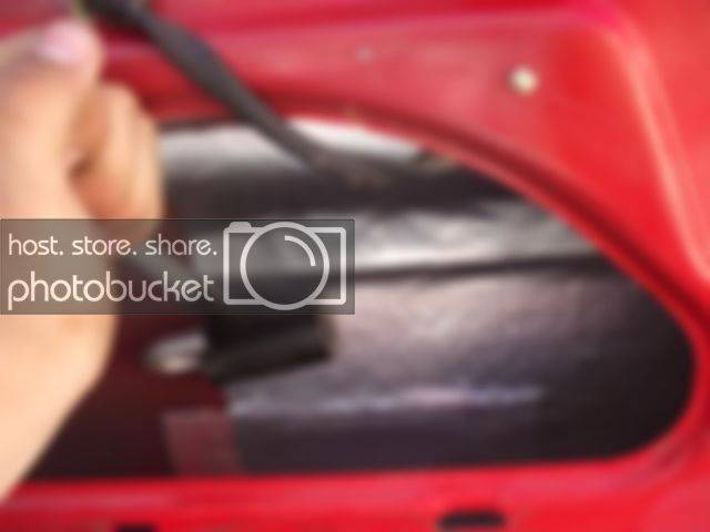

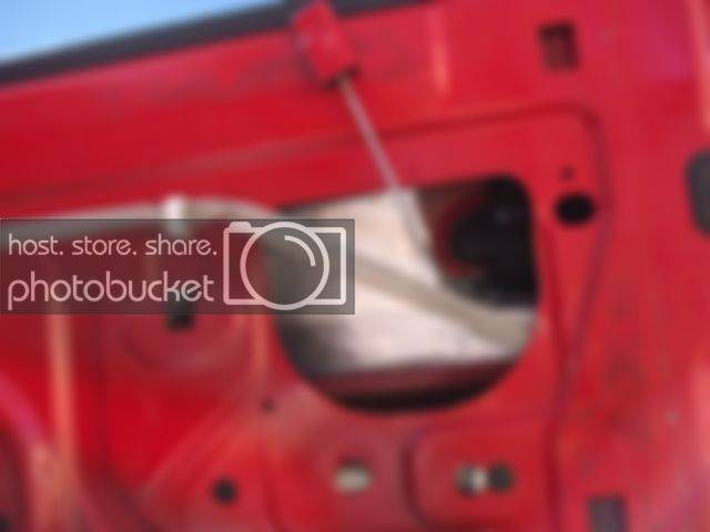

After removing your door should look something like this:
Stock sound deadener lol:

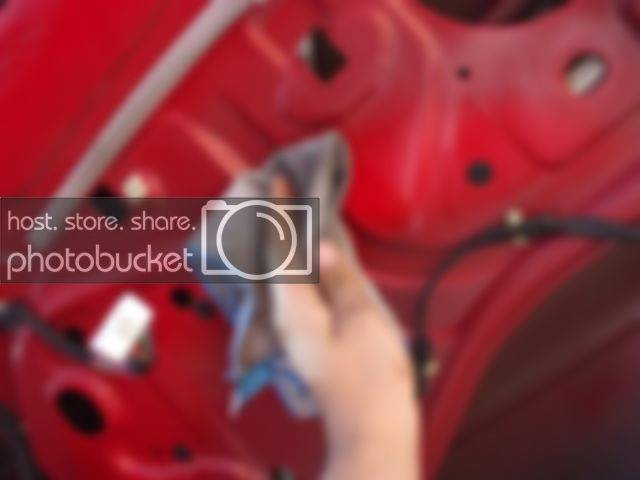

You will want to clean up all the dust and crap off the door panel with the microfiber rag and degreaser
before you lay down the sound deadener:

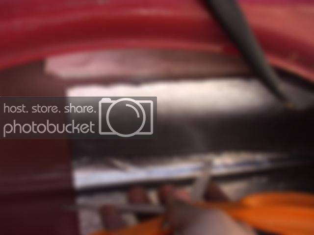

Next you will cut pieces of sound deadener to fit on the inside of the door panel. Dont be scared
to cut them to small or to big. If you make it to big just fold the left over deadener on another
area on the door. And if too small you can always cut another piece and lay it on it.

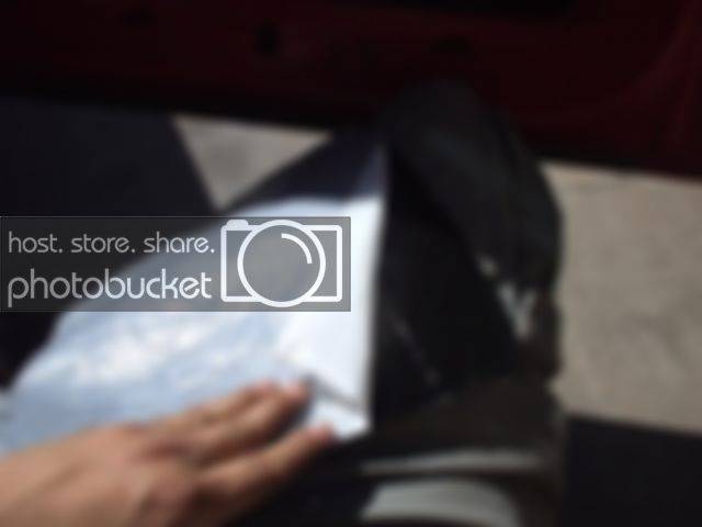

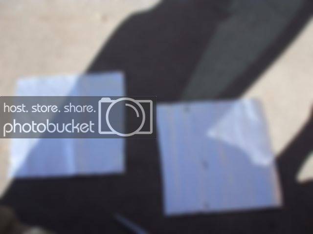

Now you will pull off the wax paper that is covering the sticky sound deadener:
Now make sure the area your going to put the deadener is clean before putting the deadener on.
And lay the deadener on the inner side of the door panel.
Once you get the deadener on the door panel try to push you hand on it to get all the air bubbles out.
Now get the Roller and roll it on top of the deadener to ensure that it is stuck on the metal good.
Now on the creases there will be areas that the deadener will not reach so you will want to used the
sissors to just make a light cut into the top layer of deadener so it will be able to let it flex over
the lower part.
After cutting it lightly just push your fingers against it and it will stick good.

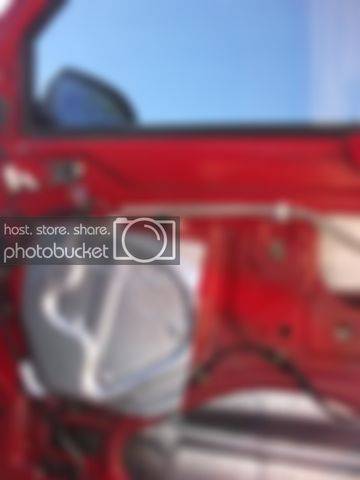

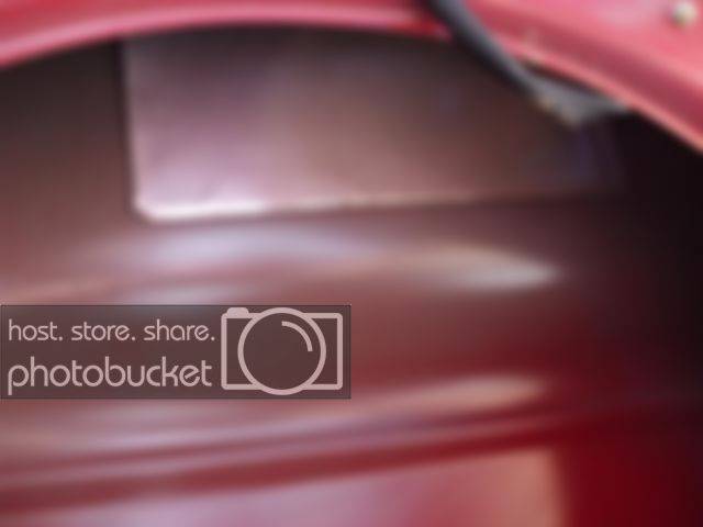

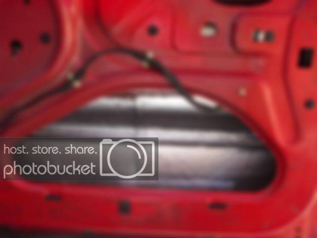

After doing the whole inside with the steps above it should look something like this:

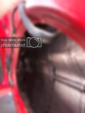

Your finished product should look like this:

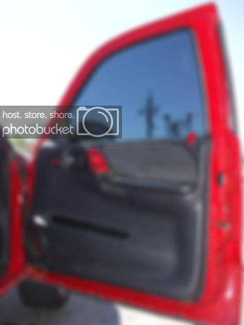

door panel on *you will never know it was there*:

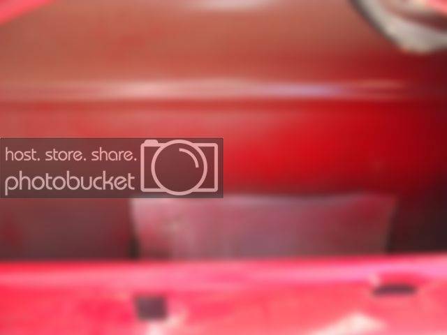

Here is how it looked when i got it:
