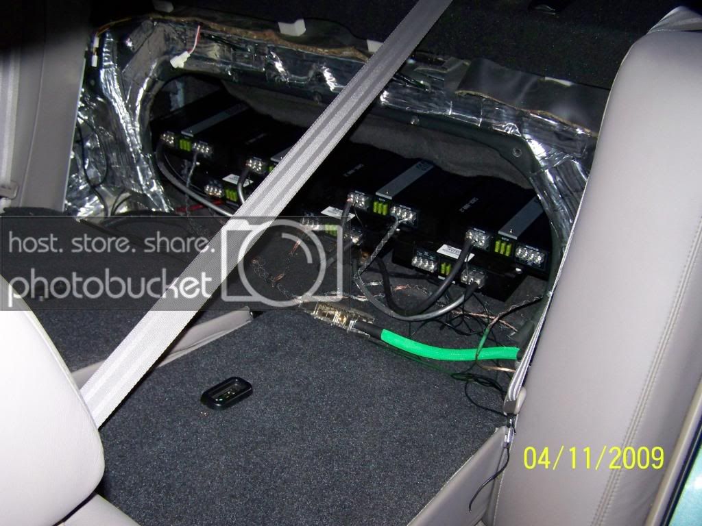

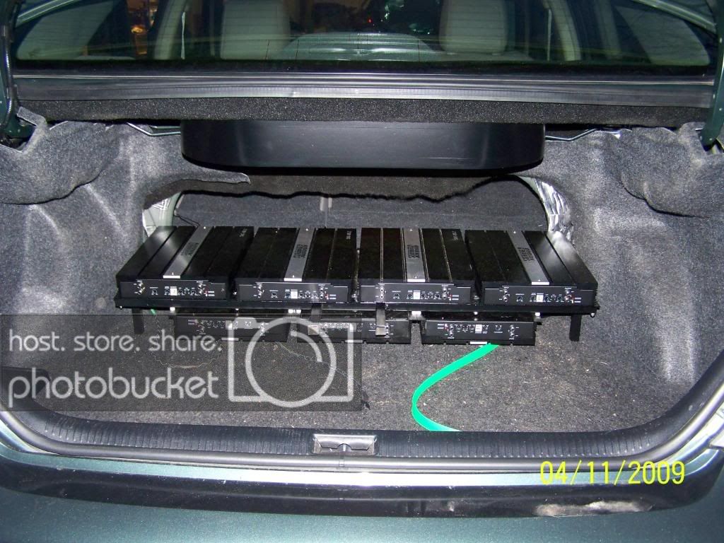

PM mlstrass. This is his trunk. He had some fans behind them to keep them cool too.
Check out your local ace hardware, they have plenty of options. In the pic above it looks like he used some coupling nuts.
But there are alot of different options....
Thanks for all the helpful replies, guys. I'm going to head over to Home Depot in the morning to see what I can find. I appreciate the pics, as well. Please post more if you have them.
Update: I stopped at Home Depot and found a clean way to mount the amps. The amps will be separated by spacers. As the Zapcos have mounting ears on their sides, I'm going to use long screws to install one directly above the other.
