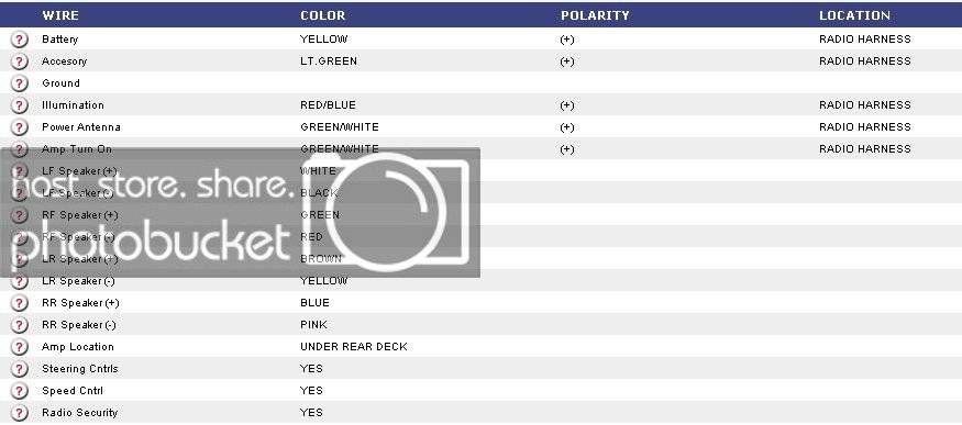

It is my understanding that I need to tap into the speaker level inputs or line level inputs. I think my car has a factory amp in the trunk. Which interface would you recommend? Also, where would be the best location to tap into the speaker/line level inputs? And what is everyones thoughts on doing this instead of a aftermarket radio. I was looking at the Rockford 3sixty? Not sure that will work.
can pick up a low level signal at the input of the amp and splice rca's in or use a SVEN4 or similar and can grab the wiring to go to the speakers at the oem amp as well

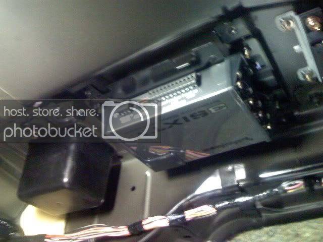

The factory amplifer is attached to the rear deck on the drivers side mounted upside down. Ive used the Alpine PXE-H650 in these cars with much success. Be sure to catch your inputs for the interface on the input side of the amplifier as those are full range signal with no signal processing...And a quick little secret run power down the passenger side of the car if you remove the battery cover and all of the surrounding plastic there will be a grommet just below the windshield very close to the fender that will drop the wire directly to the feet of the passenger.

i took out the factory bose amp and sub and put the 360 in teh factory bose amp location
since the factory radio only send out low level output to the amp catching a signal was a breeze, and finding the speaker input and output and making sure whats positive and whats negative was the only test IMO
