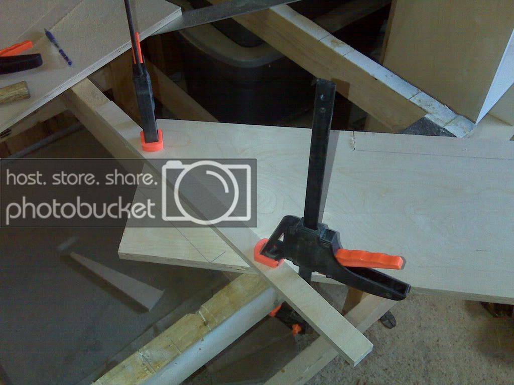

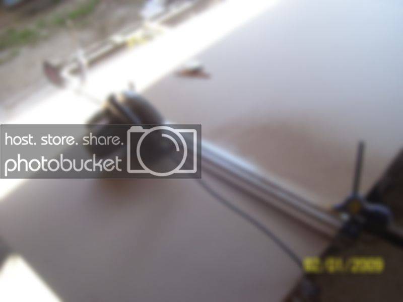

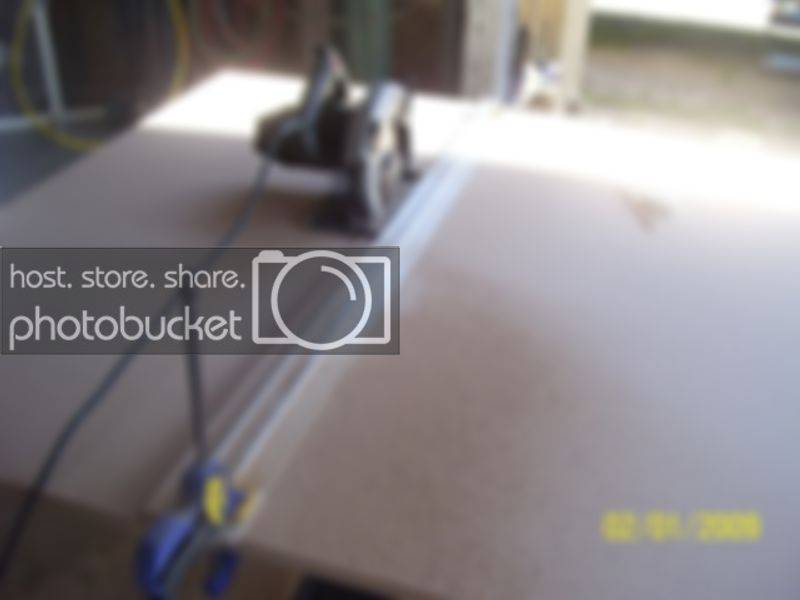

I typically use a table saw but hate running full size sheets across it so this is how I make straight cuts with the circular saw. Simply use a guide to keep the saw straight. My bro picked up this aluminum straight edge at Lowe's for a few bucks. Just make your marks and clamp it down. Of course the guide will need to be offset.
Happy cutting! //content.invisioncic.com/y282845/emoticons/smile.gif.1ebc41e1811405b213edfc4622c41e27.gif
my only suggestion is to support the piece you are cutting off as well. You will get good results at the end of the cut.

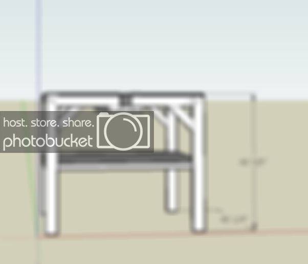

very cool man! im designing one up right now in sketchup! i will post a screenshot soon!
i figure i will post my design in here since it has something to do with the original post!
here is my design i came up with! Its nice and tall cuz im 6'2! haha has a slit down the middle for the circular saw!
