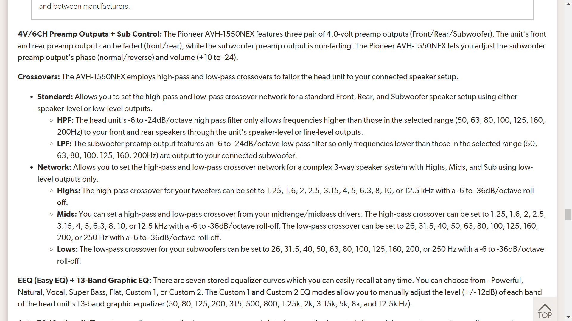

what are you talking about, literally any pioneer, kenwood, jvc, alpine touch screen double din has a 9 to 13 band EQ, some even have active network crossovers. If you are looking at android units, they are all garbage for audio, skip completely. Your old pioneer is from the stone ages, everything new now is lightyears ahead of that era.

not sure what kind of junk you are looking at that only offers bass mid and treble but we are waaaay past those kinds of head units in the modern age. I only brought up your head unit because I'm trying to make a point that you are coming from a very ancient time and the new world has many wonders for you to explore. *cue Aladdin whole new world song*
