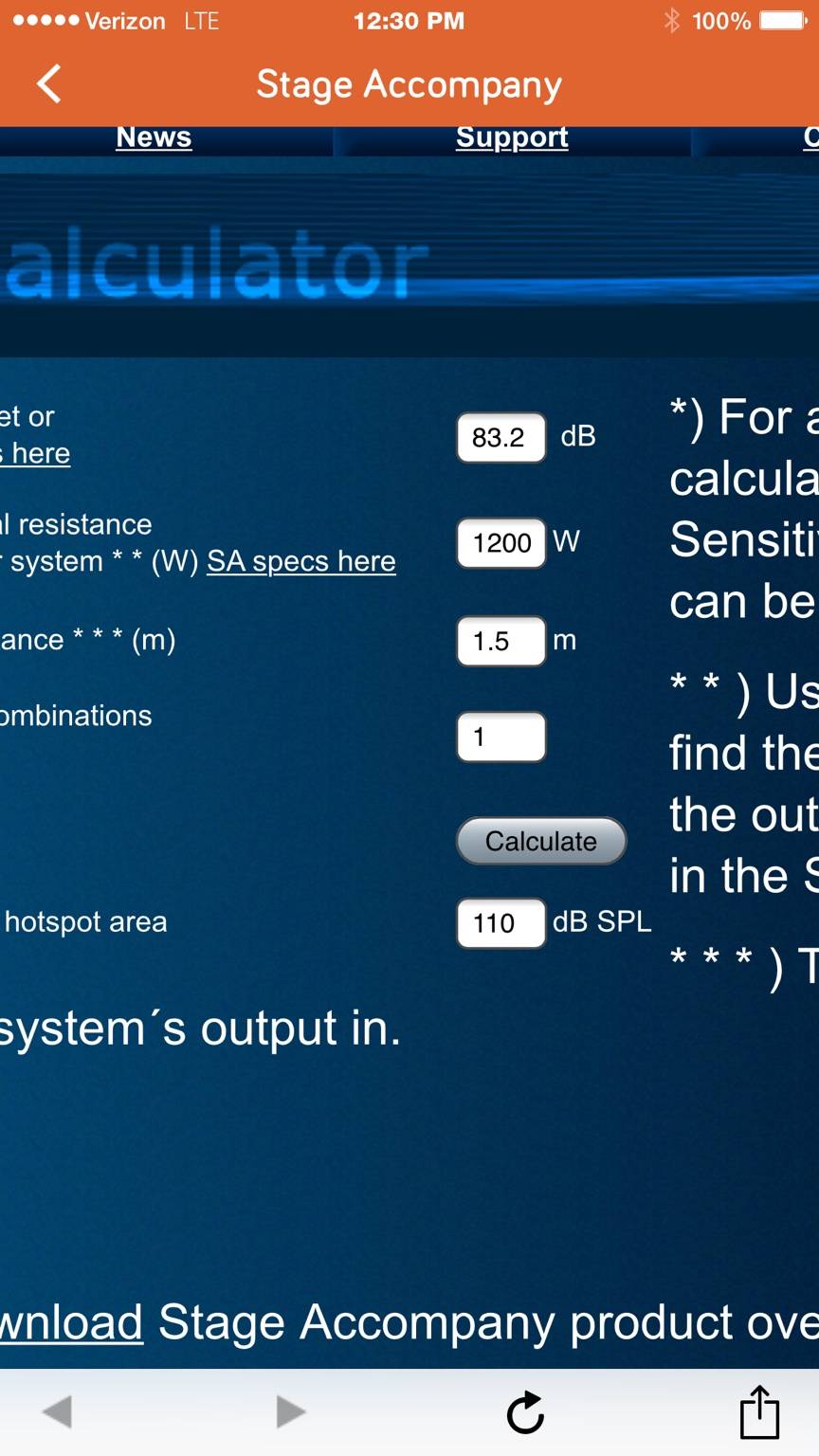

Just wrote down all the specs for JL subs to figure out the cheapest closes matching one to the W7. And trying to ask my self is it really worth the extra cash for 2 db.
The 12W0 only puts out 110 spl, right at half the sound.
That "sensitivity" spec is calculated not measured and notice they never specify at what frequency? The only time sensitivity spec is worthwhile is with full range home theater or PA type applications. It's generally worthless and can easily be fudged.

Lol that calculator is nothing to trust... I typed in my specs from my fi ssd and its way way louder than that... Don't even take that bs calculator into consideration...
Fi audio wouldn't hurt for you to look into... The ssd and q both have great sound quality...
You can't calculate projected SPL because you are missing MANY variables calculators will not have fields for because it's too complicated to measure.
That's why many people own SPL Meters so you can use the device to help get you louder and/or alter the response curve by physically seeing what is going on rather than making up a bunch of numbers.
If you like to do calculations, go purchase LEAP for several grand and several grand worth of hardware to measure the variables.
If you like to save money and still learn how things change when you are in control of it, get an SPL meter.

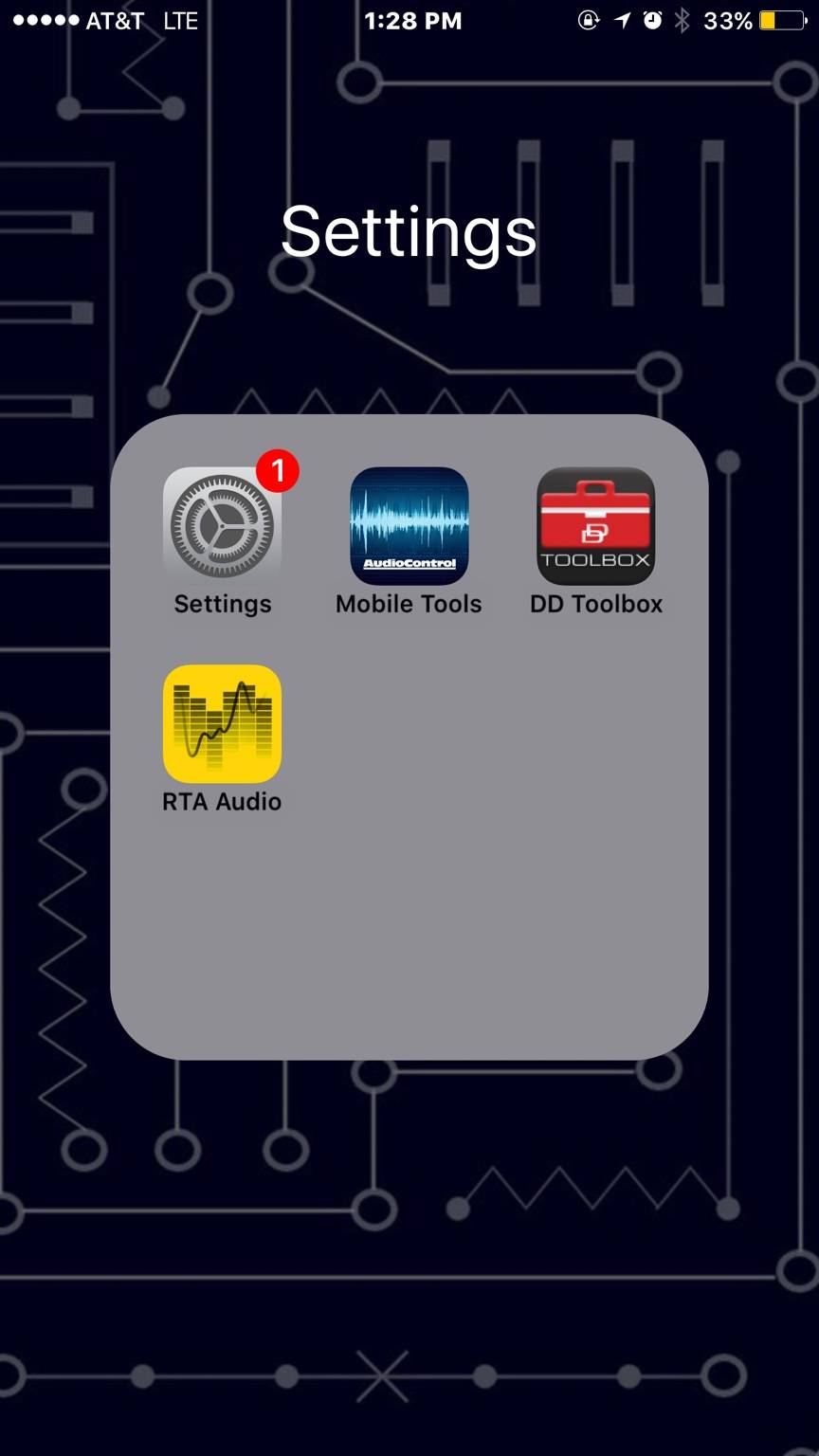

Yeah i have a few I downloaded just haven't used them
Its junk. ALL junk. Mainly because you need a proper external microphone thats made for bass testing to even achieve any form of accurate results. Your phone mic is to pick up voices, not subsonic frequencies. Thats why none of the phone apps on the market will work , not even the expensive paid ones(people get fked over with) unless its this one where you have the whole kit

if using an app on your phone, make sure you purchase the hardware for it.
Using your phone's mic.... it's not designed and incapable of measuring the decibel range for car audio use.
