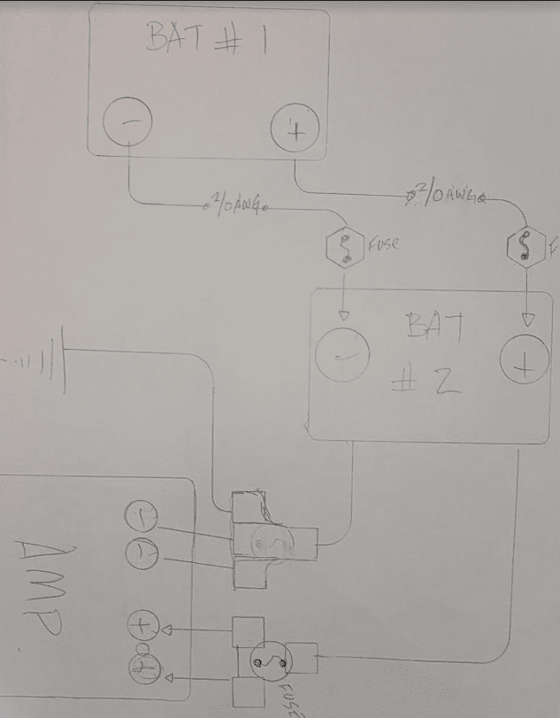

For some reason, I thought that we were talking about a different amplifier. That amp wants a dual power input too. So, yes, dual power and dual grounds, at least from the 2nd battery station. I would run a single 2/0 +/- from primary to secondary unless you're running really long runs in which case you may want to consider dual 1/0 on both the power and ground in the battery-to-battery run. I think that you'd be fine with the dual 2/0 in the battery section of the run. Then from the battery, dual 1/0 to the amp and dual 1/0 from the battery to ground with a third 1/0 going to chassis ground. I'll attach a crude drawing here in second.
No Leonardo DaVinci but you get the drift. All wiring from the 2nd battery to the amp and ground from the amp are 1/0 gauge. The main bat to bat can be 1/0 gauge too if they are not excessively long. I didn't draw the fuse(s) for the primary battery, it is assumed you have fused within 18" of the primary battery.

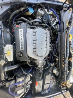

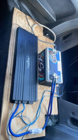

heres the set up as of now, it dont look so organized or pretty but me and a buddy threw it together in a night just to get them runnin, onces we get another day and night together we are gonna clean it up

Yup, definitely get another run to the other side, get the 3 input block, run two back to the block, block to the 2nd battery like the drawing, the third to the chases ground and your good to go.

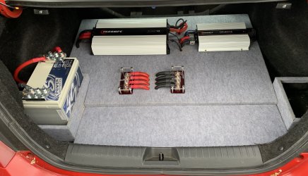

Distro blocks make everything look cleaner, make for perfect connections, and make it easier. I like using blocks that accept ring terminals and use ferrules over the wire into the amps.
Yeah, I can be lazy for sure, ferrules and heatshrink and an allen wrench work too. Have a great 16 to 2/0AWG compound crimper tool and still...
Blocks that accept the wire bare or with ferrules are great too just I have ocd and like the way ring terminals look 🤣. When I build subs I always do direct leads and when I install them I use ring terminals for those connections too 😅
