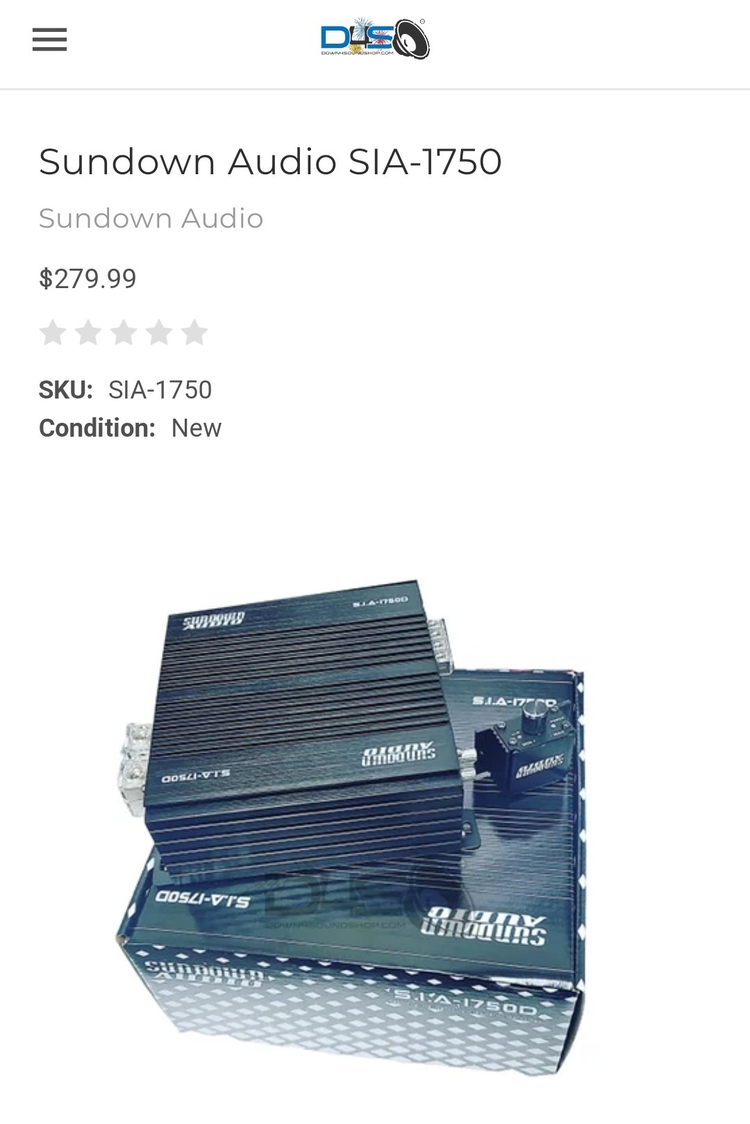

Why does it have to be two channel? You can get a Sundown SFB1500 for that money. And the SIA1750 (better amp than the SFB) should be in stock now at Down4Sound.

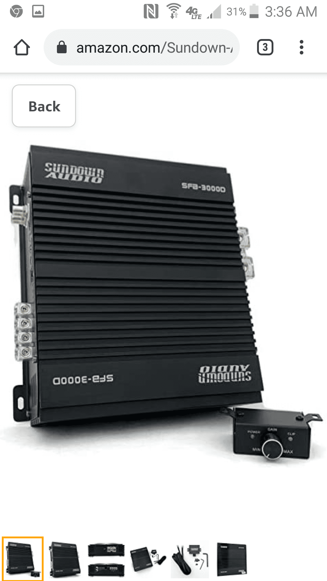

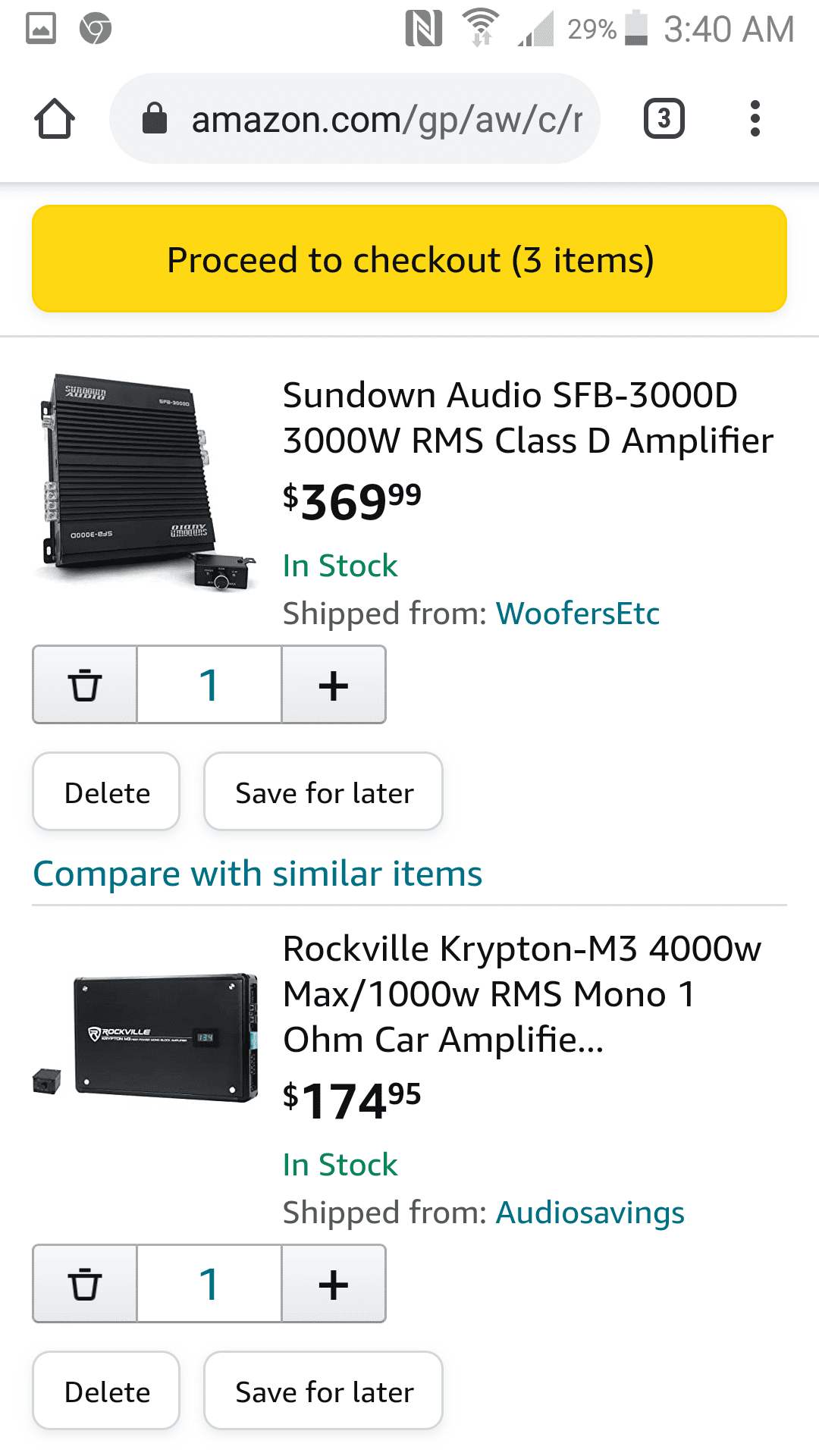

I like this one. It's around $400 with taxes shipping n handeling. I wouldn't have a problem spending $400 so that I can start finishing my trunk build in.

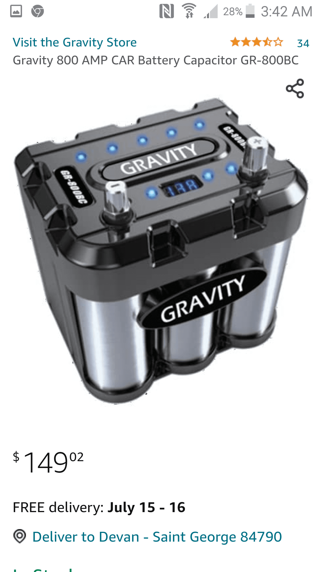

What are your thoughtS about spending money on this?
Probably a poor investment. Just go to a parts store and buy their AGM "premium" or "platinum" line or whatever AGM has the best warranty. Bonus points pick a nationwide parts chain so that if/when the battery fails you can just exchange it over the counter, in person, anywhere in the country with zero hassle or return shipping charges.

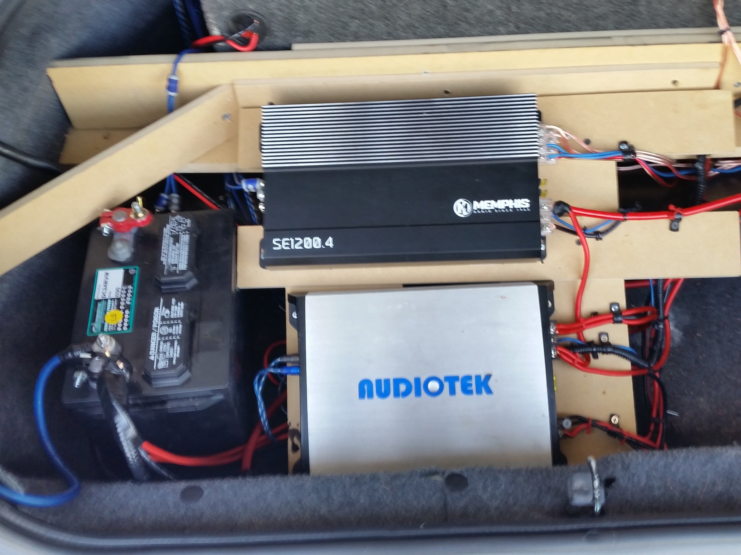

Already have a deep cycle battery in the trunk ; )
Also have a 220 amp high output altenator that was installed by a master mechanic. The deep cycle battery gets connected at the positive battery terminal after I start the car, and then disconnect before turning off the car. I was going to have a part put on it that automatically does this that is inexpensive. My master mechanic advised against it because of the eventual event that it fails it's purpose of isolating the battery within my engine compartment from the deep cycle battery when the car isn't running.

That deep cycle in your trunk is a flooded battery it will never be the same as a decent agm battery.
The alt you bought is likely only putting out decent amperage at high rpm. Car audio alts run smaller pulleys so at idle the spin the same speed as a regular alt at high rpm. This lessens the life span of the alt but you get alot more power at low rpm.

My suggestion to to pick up one of those amps first recommended because you don't have the electrical to supply 300+ amps to a 3000w amplifier.
I didn't even look at the wiring you have but if you don't have a quality 1/0 power cable ran from the alt to the batteries both front and rear you don't have anyway to support 300amps of power draw.
You can use distribution blocks to downsize the wire in the trunk, or just use your rear battery post.
My honest suggestion and one you can do in steps is
1. Replace that amp with the sfp1500
2. Build a custom box designed by someone like @Buck or @shredder2. I would not bother building a box for those Rockville speakers but you can use those speakers as a fill gap.
3. Pick up any decent 750-1000w rms sub sundown sa series, incriminator lethal injection, digital designs 2500 series, daton ho or ultimax, pretty sure ssa makes one as well as fi caraudio.
Pick the subs you want as an end goal and have the box designed around those subs. That way you can swap the Rockvilles at any time and have a custom enclosure for the new better subwoofers.

This amp will give you 1,750 watts @ 1 ohm. It was just released from Sundown.
