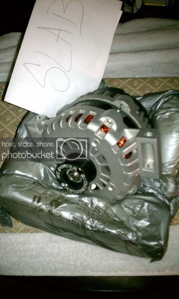

Just got my DC power alt in..//content.invisioncic.com/y282845/emoticons/biggrin.gif.d71a5d36fcbab170f2364c9f2e3946cb.gif...so im wondering if i can install it myself?

cant wait to get this bad boy in...this is a 270A SP, but i really ordered a 250A XP.....but they are on backorder or something so i have to wait three to six weeks, untill then i guess im going to have to suffice with this.

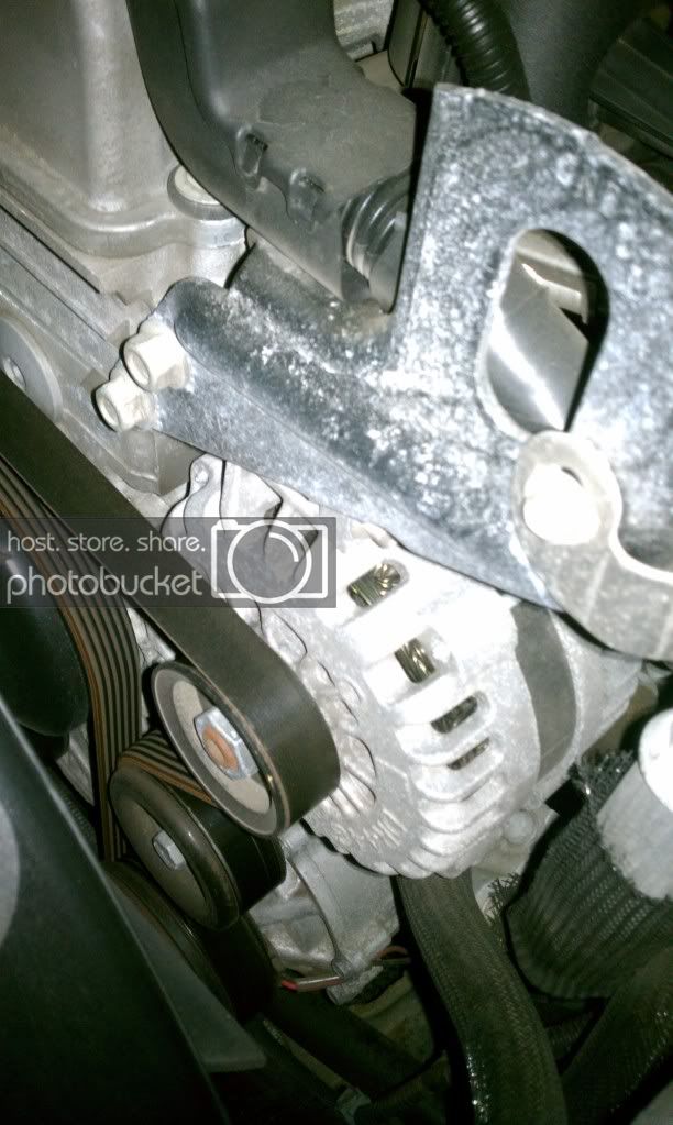

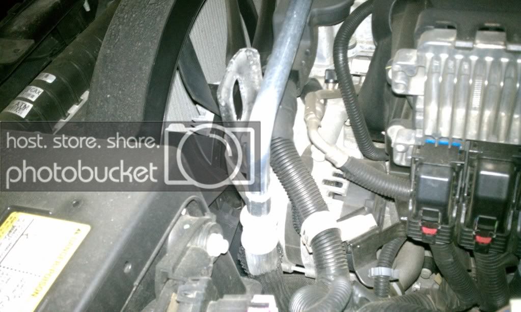

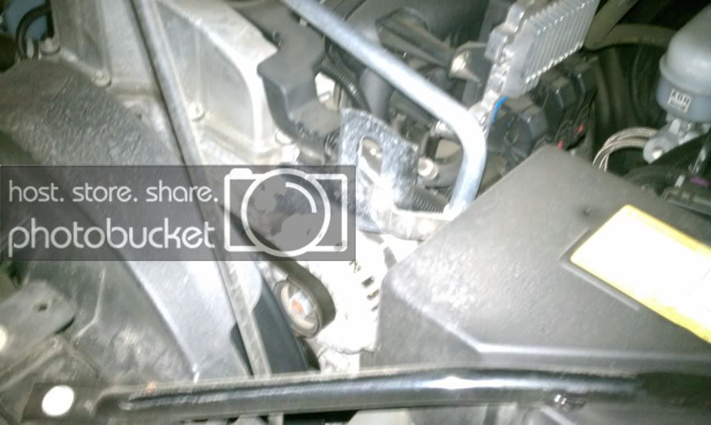

idont know it doesnt look that hard to get to but i could be wrong. what do yall think?
Take off your battery cables. Unhook all wiring/plugs from the alt. Untension the belt. Unbolt the alt. Install in reverse order.
It should come out without having to move much else, if anything. Bungie cords are nice to use to hold things back out of the way if you have to move anything.
You may just have to take things that are on top or in the way off as well. Not that hard as it looks to be pretty much on top. What all are you running? The SP is an awesome line though.
