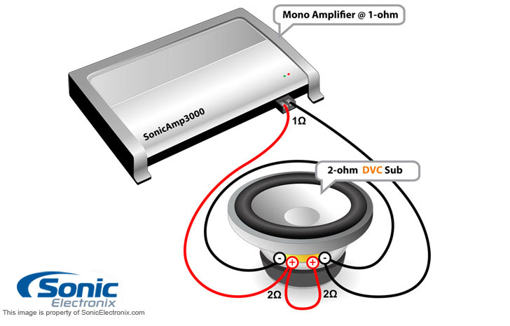

how come we wire subs like this?
I there a reason why they link the positives on the left side but on the right side the link the negatives.
Instead of something like this^
