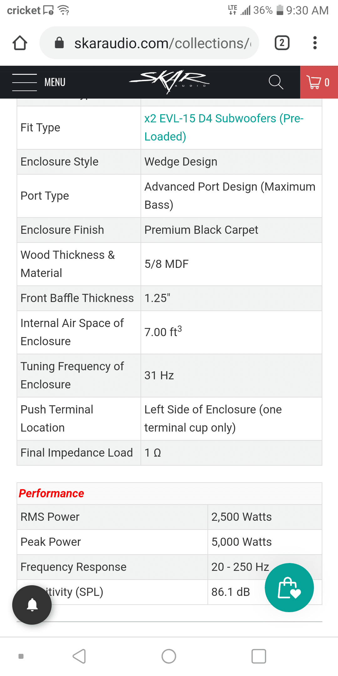

I upgraded to a Mechman alternator and added a XS D3400 battery. I took a screenshot of the box specs.

Yes, this is the box. It is currently sitting on its back with the subs firing up. And I did change to a Mechman alternator and added an XS D3400 battery
Running it through software, it appears that they are manufactured as sealed subs, optimally. 3.5 cubes sealed according to my software. 6.5 cubes ported, which is a fairly large box for a 15. Not very efficient subs on the box size.
