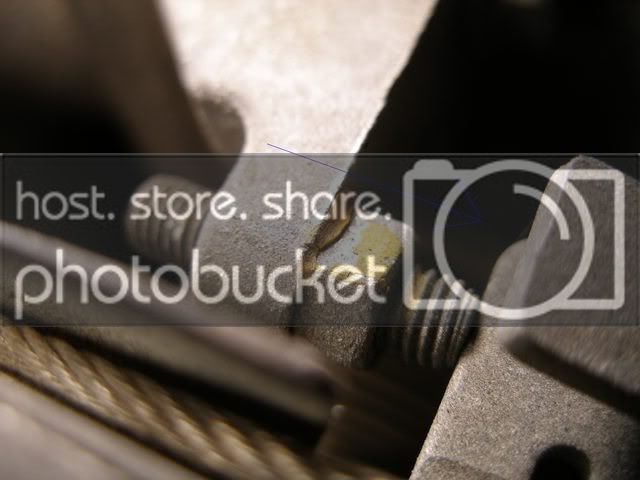

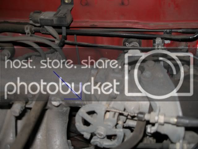

Here is the screw we are talking about in my car. This is on top of the engine.

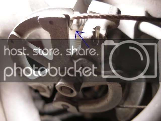

Behind the throttle as shown here
And here is the screw. The screw goes in the direction of the arrow to increase the rpm's.
