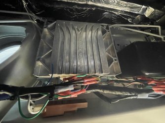

I have included more speakers, stock HU, stock amp. It’s a hertz cento c26 speaker.

I didn't play your video, but that sounds like a ground loop. A loose or bad ground causing interference.
Honestly the place where you should start... What have you modified? What bolts have you or someone else touched. What electrical have you changed or added. Probably 6 months to a year ago... maybe 5-10k miles ago....
I would bet almost anything it's not something that came way from the factory and went bad in 3 years. Not knowing if you have done anything to the vehicle, I think it's something you or someone else did to the vehicle, and that ground has come loose.
