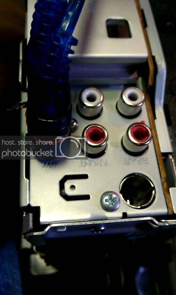

I just recently bought a JVC Kds79Bt (I cant post the link to it from my phone). It has 3 sets of pre outs a front, a rear and a sub out im using the sub out and when I turn on the high pasd filter it almost cocompletely cuts all bass out from my sub. I can go into sub controls on the hu and turn the sub up and down or off so its plugged into the right pre out. Does anybody else have any experience with a jvc doing this? Or is thete something wrong with mine?
That's what i thought at first but i can still turn the sub up amd down and set the low pass for it with the sub control so im pretty positive it's in the right one but ill pull it out and double check.
Alright so it's definitely plugged into the right pre outs. Wth jvc apparently I shouldve stuck with pioneer.
