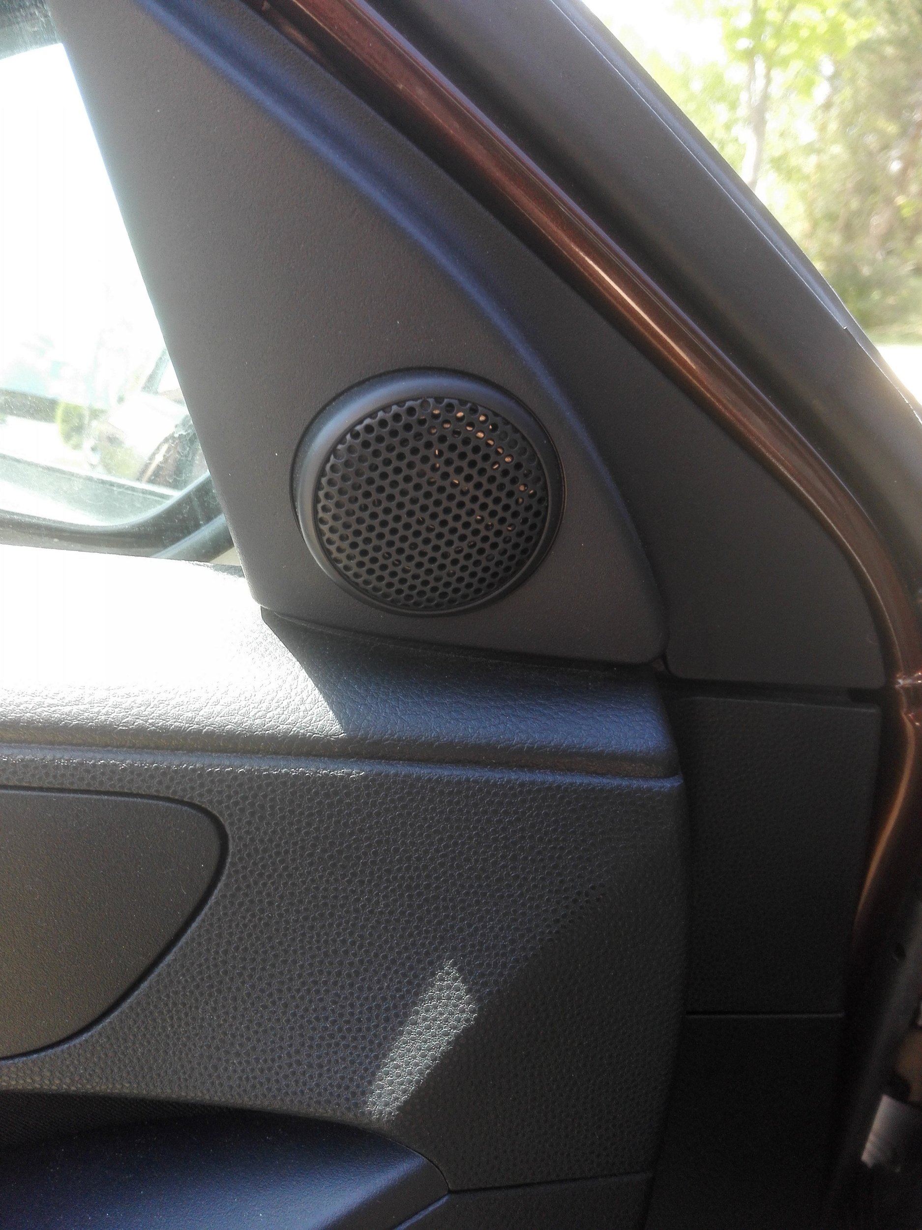

Maybe post up a pic of the speaker. Does the little speaker play music with the other speakers?

That's the speaker.
28612
Unfortunately I couldn't catch the sound with my smartphone.
Oh ok, so that's a tweeter. Man, it sounds like you're getting speaker noise from your new electronics, or something isn't connected correctly. I can't really help you because I'd have to be there to even begin to try to figure that out. Like you'd have to find someone willing to dive into that problem for you, and it may not even be fixable. Don't buy crap from China!

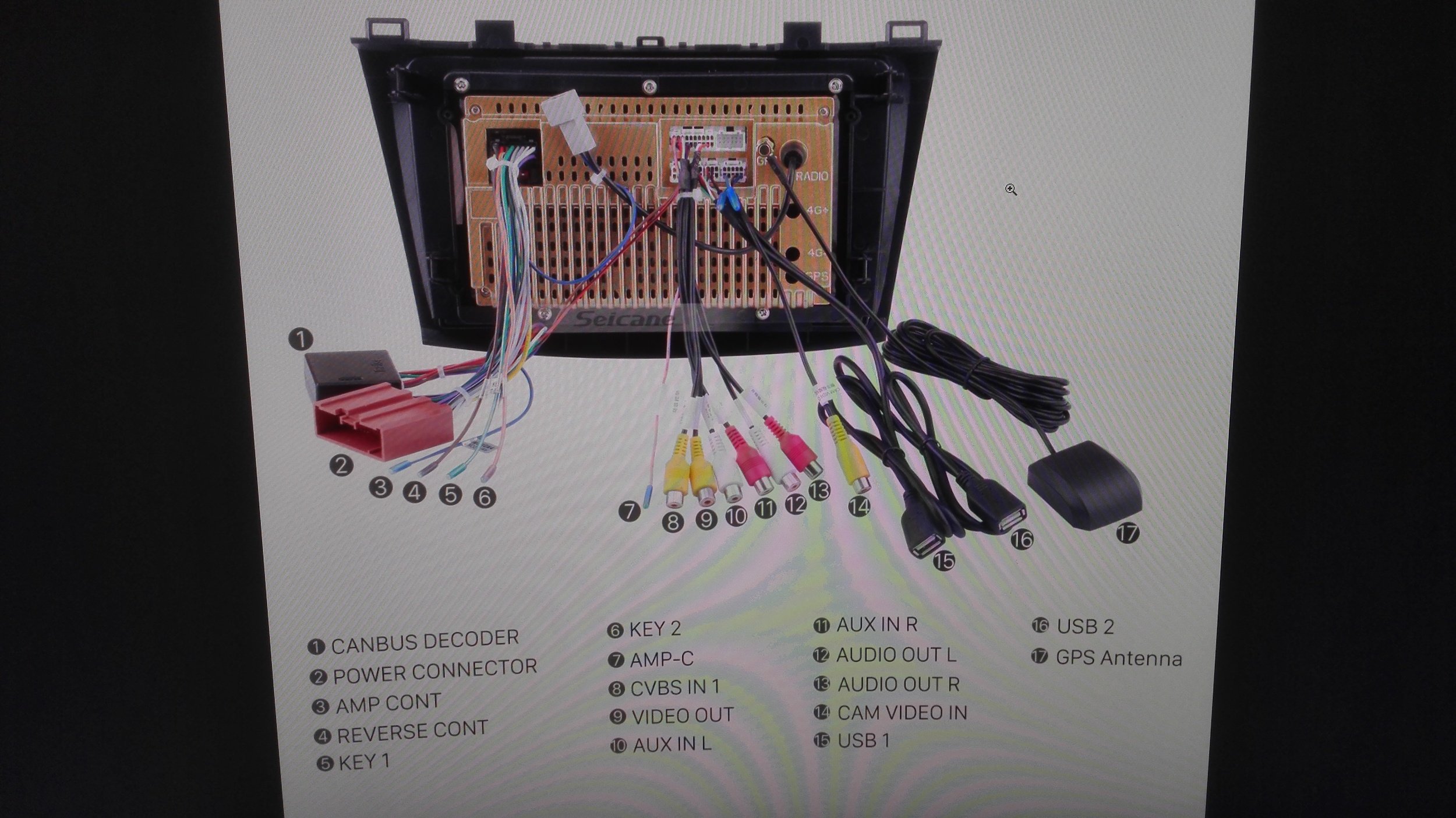

Here is a picture of a similar headunit from an US retailer.
28616
I just had to connect 3 and 7 on the picture, so the amplifier could gain its power. Power connector and antenna were just Plug & Play.
Anyway, thanks for your effort. :)
