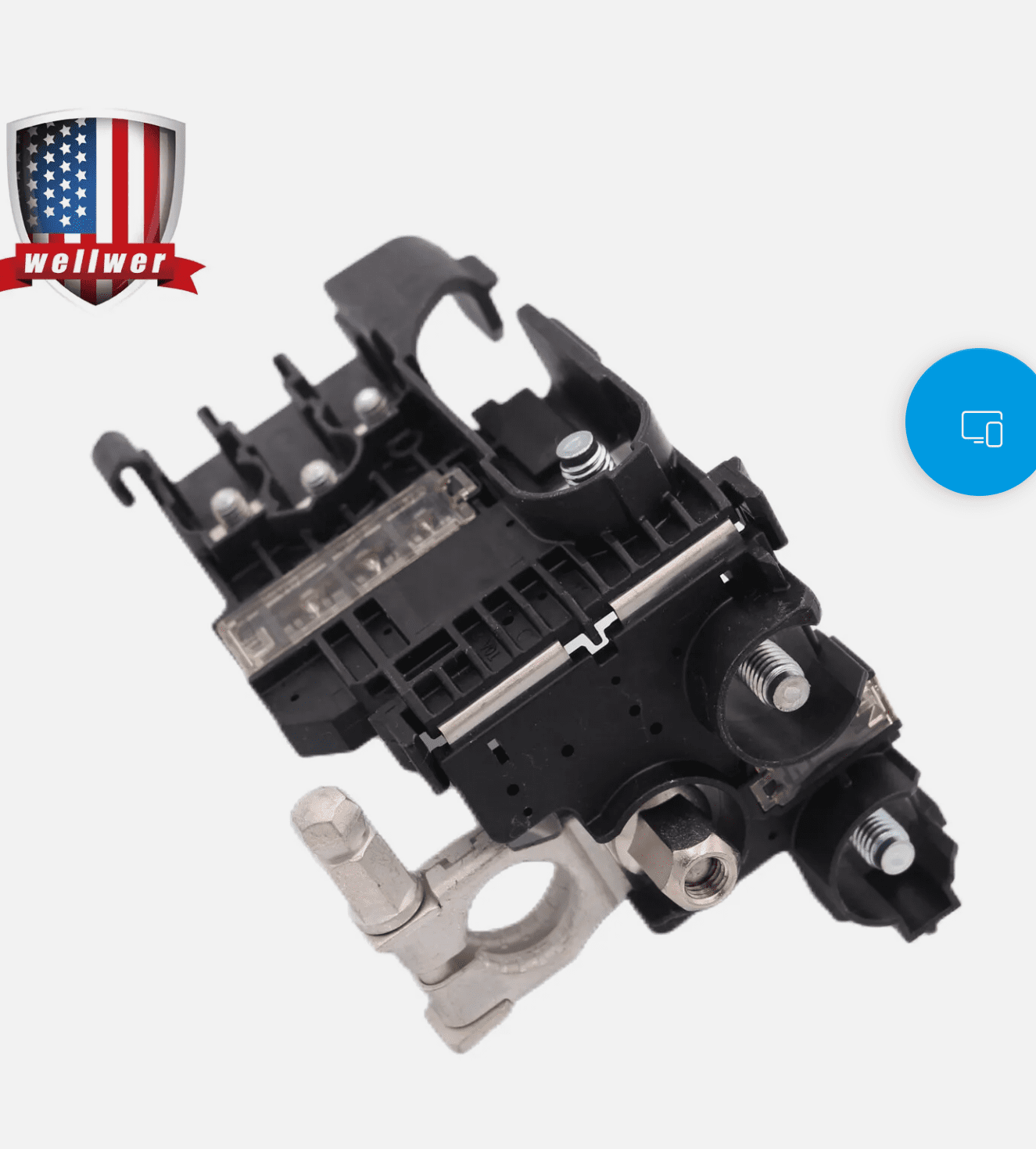

If you bypassed the fuse and the car started, then it may be a burned terminal fuse. Reason is that the ECU needs to "see" the battery's charge level to prevent overcharging and optimize fuel economy.
On older cars, an easy alternator test was to just remove the battery terminal while the car was on. If it remained running, alternator was still working. On new cars, if you remove the terminal, the car shuts off. Same happens if that terminal fuse burns out. Try checking the fuse with a multimeter.
terminal fuse? that would be the fuse on the power on the battery or where would i find it?
It would look something like this.
But now that you asked that question, when you said you removed the fuse, were you referring to the amplifier's wire fuse?
yes the amp fuse. i actually went to the battery shop n they said jt was fried, i just put a new one in and it works good now. im just confused that the battery fried instead of the fuse popping
