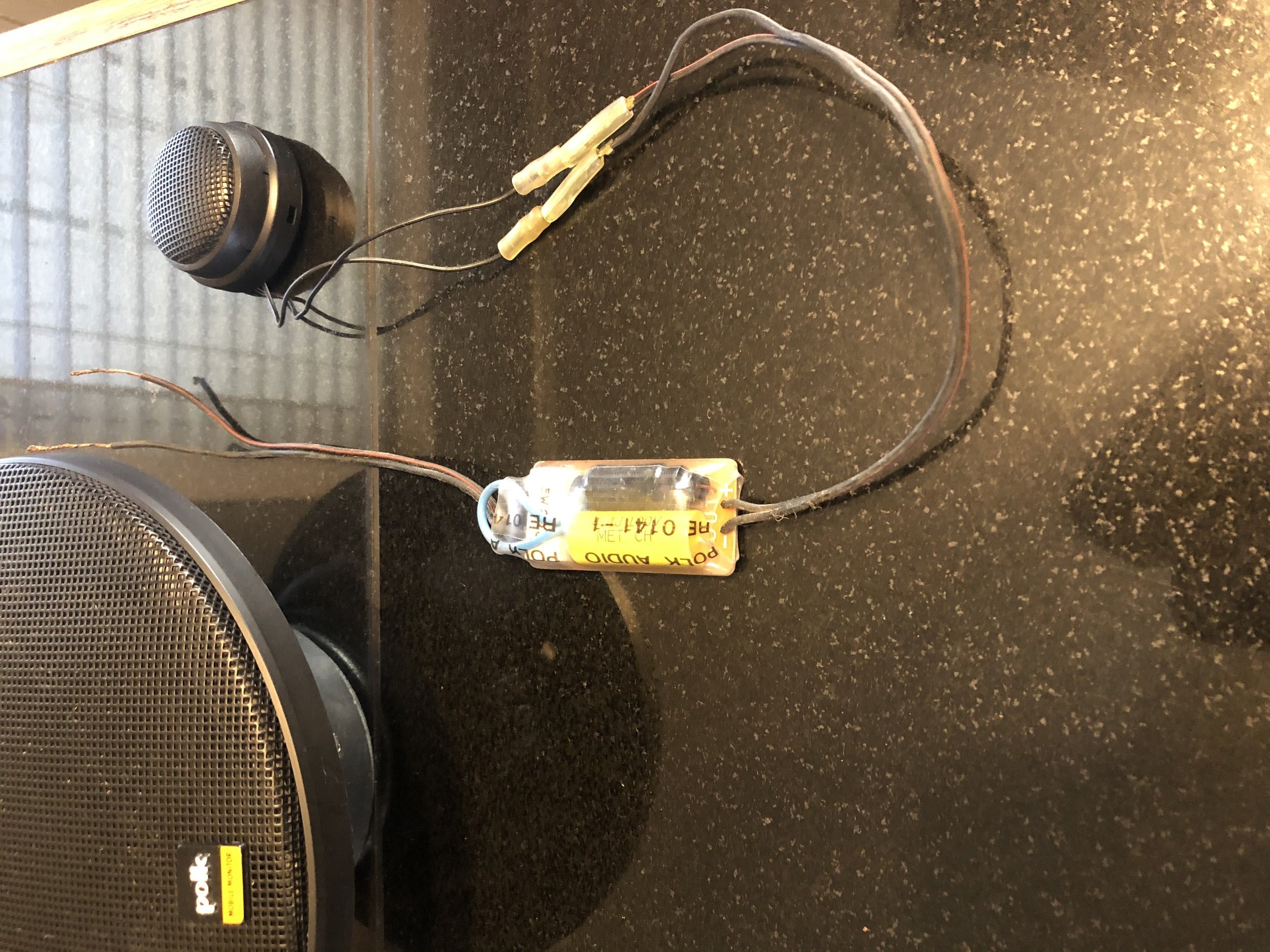

Can someone please help me with the wiring of these speakers? (Polk MM6510’s) I’ve been storing them since 1995 and I’ve forgotten how I wired them.

Would the attached link help you? https://www.wikihow.com/Install-Tweeters
Seems that the crossover for the tweeter is located in the yellow wrapped components. If it is, there is no need to purchase a separate crossover. Wire the large speaker first to see how it sounds. Then wire the tweeters as described in the link. There is a lot of speaker/tweeter how-to on the internet.
Good luck.
