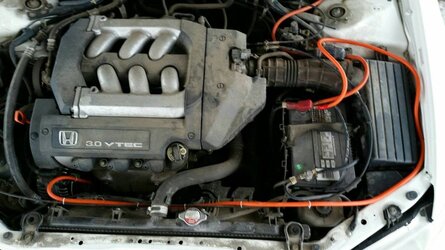

This is my underhood mess lol

yeah, its not bad under there, but i should get some good terminals and shorten up a wire or 3 under there
i also just realized that this pic doesnt have the ground from the engine block to the chasis which goes right next to the other one up by the drivers headlight. i need to take new pics as its been there for over a year or so LOLOL!!!
