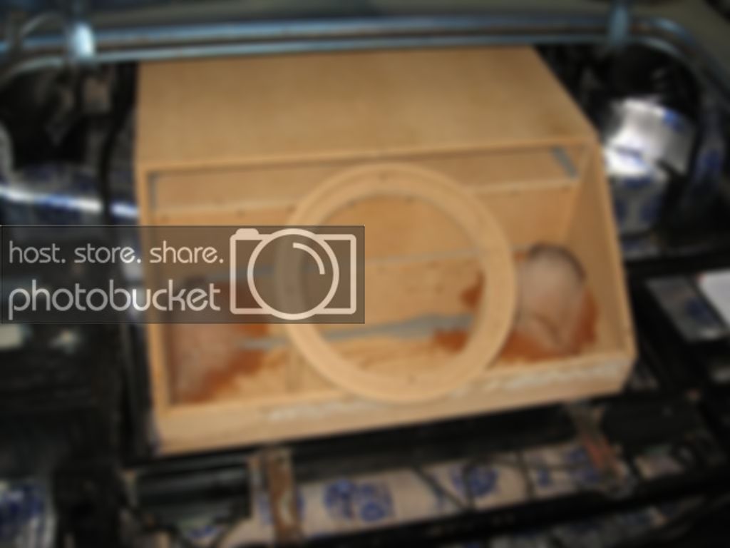

I'm well into my box building project. The remaining issue is the port.
I have 3.8 cuft box I want tuned to 33Hz
The online calculator stuff I've used comes up with a slot port of 6"W x 3" H x 5.22" L which seems small to me.
Can someone point me in the right direction here. I don't have a lot of room to work with either about 8" on either side of the sub
is it already built and your putting the port in? and what car are you putting this in and maybe some pics would help for starts.
The box is mostly built, I just have to get the port sorted out and fiberglass what will become the baffle.
I originally used some of the online calculators you can find to get my port area, but when I double checked with some people that are "in the know" they all said it looks too small for the woofer. That's why I'm confused. I thought a formula is a formula...
The car it's going in is a 64 Impala, but there is VERY limited room in the trunk

It doesn't look like you have anywhere near enough room to port. It also doesn't look like you have anywhere near 4 cubes either.

As far as it "looking" like I don't have near 4 cubes...my measurements say different. It's also in the trunk of a 64 Impala, which if you're not familiar with is HUGE....that might be a reason why it "looks" small to you

I don't give a **** how many posts you have and it matters not. What "formula" are you using to get port area. If you were planning on using 18in^2 of port area, you would get a lot of port noise and things would sound terrible.
What other enclosures have you built (I'm looking for size and port specs)? For what subs? With what kind of power?
You may be able to get away with a slot port heading back into that top area you have there but without dimensions, there is no way to know.

the dimensions for the "top" part are 35.5" W x 5.5" H x 16.5" L

What about dimensions to the other parts of the enclosure? I can possibly make a sketchup of it and see how a possible port could fit. With that sub, you're going to want about 40-50in^2 of port area.
I would actually run that sub sealed but it shouldn't sound bad in about 3.5 cubes at 32hz or so.

the formula they claim to use is ((14630000*(D/2)*(D/2))/((Fb*Fb*Vb*1728)-(1463*(D/2))))
I use 4" as the diameter simply because someone mentioned 4" aero port
box volume 3.8 cuft tuning 33 Hz Length = 5.22 inches
the bottom part of the box 34.5 x 12 x 8
the triangular middle part is 13.5 x 11 x 17.5
that's all internal dimensions also.
