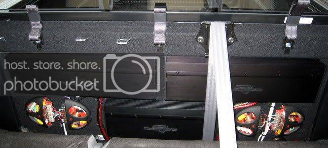

I have Morel Elates and love them. Elate 9's in the doors, Elate 5's in kickpanels and Elate 5" in center all powered by Zapco dc 1000.4 and a 360.4. Sounds like I am at a live concert.
I have a 1100.1 running my subs now but going to switch that out for a C2K 9.0 and a different sub.

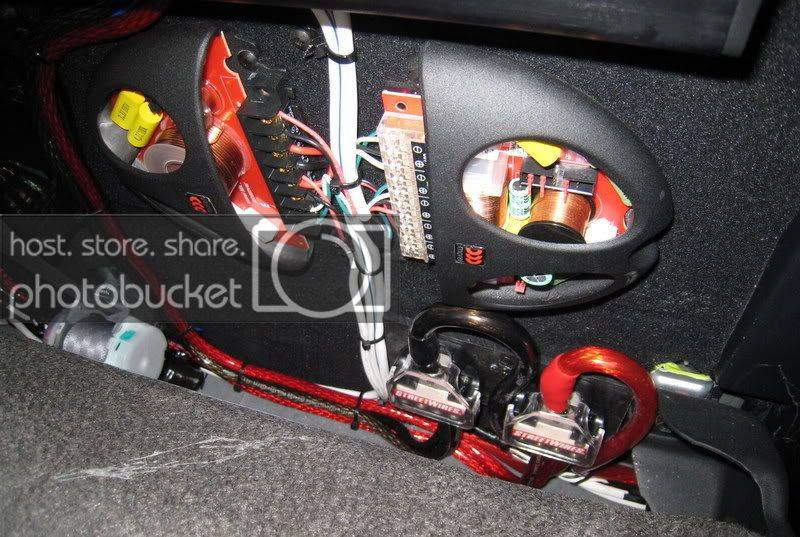

The Elate crossover...
i don't even understand why someone would run that passively.... makes me wanna vomit, unless i missed something (which is completely possible so dont hate lol.)
I.E> I envy your gear, i have lesser gear running active, if i was you i would take advantage of running my shit active if i spent that much money, and i want your stuff to take home please. I can give you an address to send it to.
