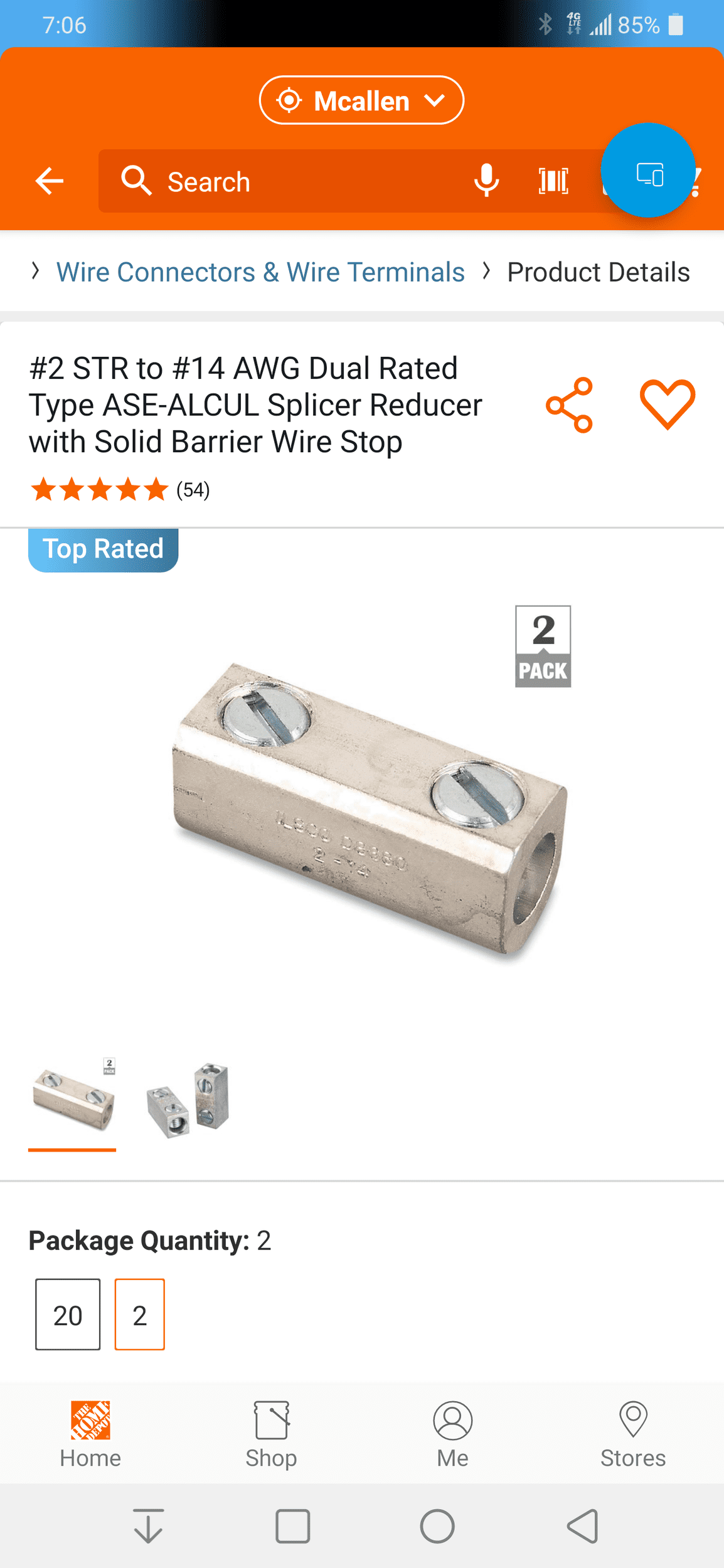

Signal highs through speakers for the signal and factory HU. For the power 14awg tiein to 8awg would you twist and pop on a terminal connector or solder?
I like using these for splicing oddball sizes
. Not permanent but a solid connection.
