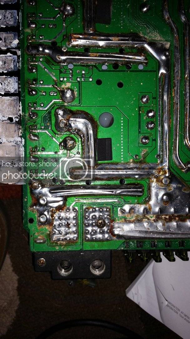

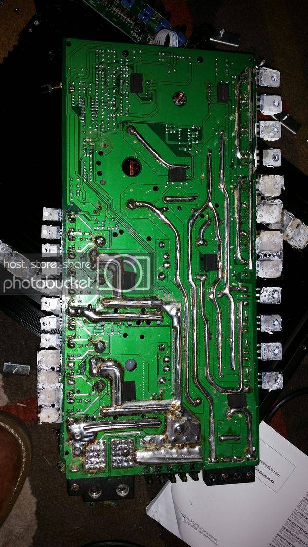

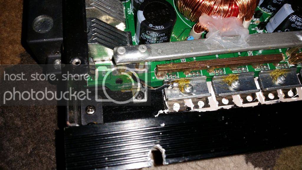

Had the exact same problem with my sae-1200d within a month after I got it(bnib). I had no problems the whole time I had my PPI p1000.1, and I regretted the swap.
I was ready to throw the thing in the trash when I took it apart and saw the build quality.
Check and see if this little wire(ground?) is burned up like mine was.

Dang that looks bad. Well I fixed the issue of the high bass I had to change some settings around on my hu and the amp and now I got my truck roof flexing and its in a sealed box the amp gain isn't even a quarter turned on the amp I had my ppi at full gain and it barely moved theses subs and would cut out all the time had to turn the car off and back on every time it happened couldn't even turn the volume past 20 my hu goes to 62
