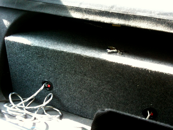

I have a question about acoustical advantage of free air-space relative to subwoofer enclosure placement and potential. I ride with my seats down due to the tendency for the bass resonating from the subwoofers to get louder/deeper/cleaner. Seat to trunk is not sealed, the height of the enclosure I currently use allows the additional dimension of of a 4" height x 36" gap of unblocked/free air space for the bass to travel within the chamber of the vehicle itself, which, I believe lends an additional acoustic element to the set-up. Everythings fine why touch it right, the problem is im getting a new custom ported enclosure made which will house two sundown sa-12's, the dimensions of the box im told will have to be a taller, deeper etc to maximize the potential of said woofers. The problem is the dimensions of the new box would be around 18" in a 20" maximum height trunk which would cover the 4" height x 36 width gap, my current enclosure allows. I'm thinking of going a few inches deeper so I can keep some that free air-space, but not really sure it would matter as long as the seats are down. What would you do(?).
I'm told cubit's are cubits, so I suppose it would not hurt to go deeper if I wanted to keep that space, my trunk is around 32-33 inches deep, the depth of the new box in theory would be 23" deep. Here are a look at a few specs. The current measurements of my enclosure, 36"w x 16"d x 13"h. The measurements suggested for the Sa-12''s, 38"w x 18"d x 18"h. The measurements that would allow me to keep the air-space by making the box deeper, 38"w x 23"d x 13"h I'm spending good money to have the box made, just rather have it compliment the automobile I have, a 1999 Jetta. Anyhow, I'd also like to ask for anyone that's willing to help, are there any suggestions as to how the port and subwoofers should be aimed, whether port back, woofers up etc. Thanks.

Best bet here is if your going to be blocking most of the space for the wave to go into the cabin then you need to block ALL of it and turn the box around.. Instead of using a smaller box and firing it rearwards to allow the backwave to enter the cabin, turn the box forwards and seal it off from the cabin.

I've tried turning the box around facing the inside chamber of the vehicle with the seats down before, sounded really bad.

Well if you don't want to do that then make make the box a bit deeper and less tall.. you dont have to do 18 tall as long as you have be correct airspace still.. usually if your going to face the trunk kid the shorter the box the better. If your box gets very big a side firing port can help too but in your case is fire it all back at the trunk

When you face a box forward in your trunk like this, you have to seal it completely from the truck to the cabin, or else yes, it will sound like shit.

I'm likely to go with a deeper box. 13" height is really quite minimal for two Sundown SA-12's, but then the depth would be in the 23"-24" area with a width of 38".
That would allow me to keep that open gap of air. I think I'm making the right choice, but if not I hope someone will let me know. Also having the box at 13" actually
allows me to pull the enclosure through 2"-3"s through that covey, with a taller box around 18", that 4" x 36" gap would not necessarily be completely sealed, but, I
feel keeping that gap of unblocked air-space allows the bass waves to have more free access to the chamber of the vehicle which creates an additional acoustical advantage.
