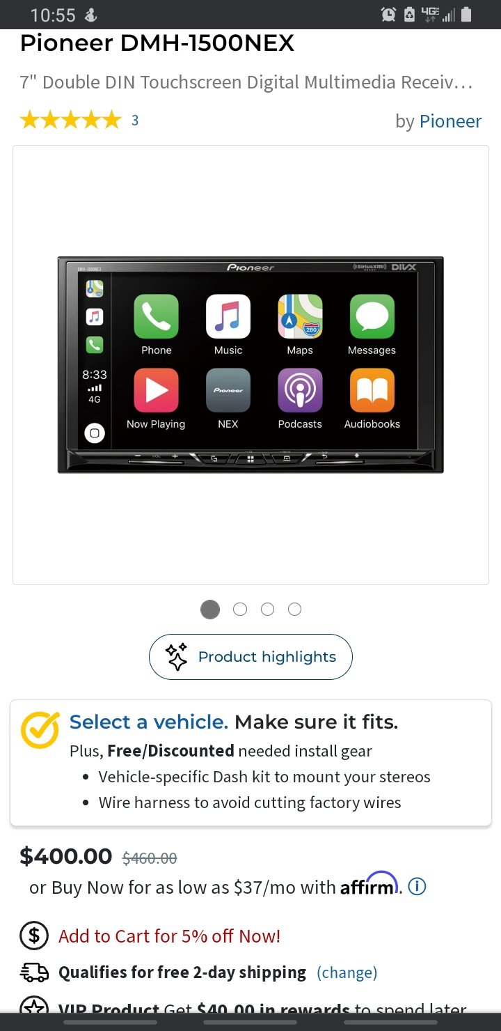

A 4 volt or 5 volt preout headunit will be just fine. I don't think they really make over 5 volt headunits anymore. Are you single or double din? I'm guessing double din. Look at the Kenwood Excelon series.
Yea i just went to the shop and theyre exact words were “i recommend a new stereo, just because a new HU would get you 8+ volts for preouts compared to a stock HU and an audio control LC7i” 😂
I was wrong. This Pioneer has 7 volt preouts. That's pretty good.
