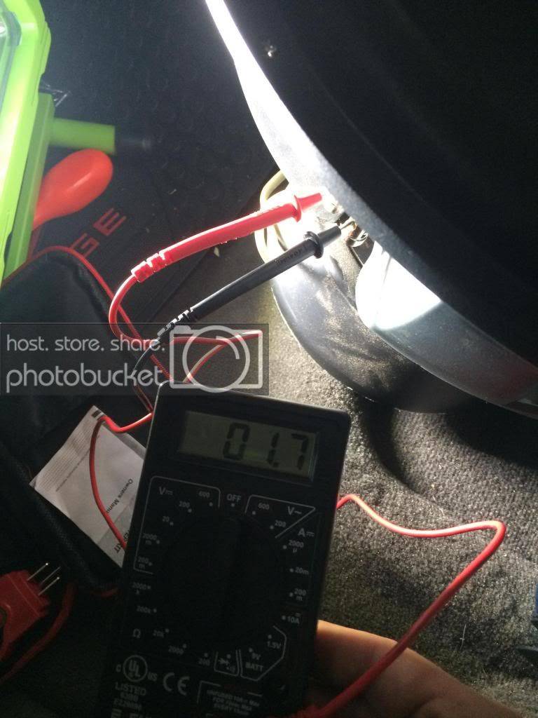

I got 1.7 on each side

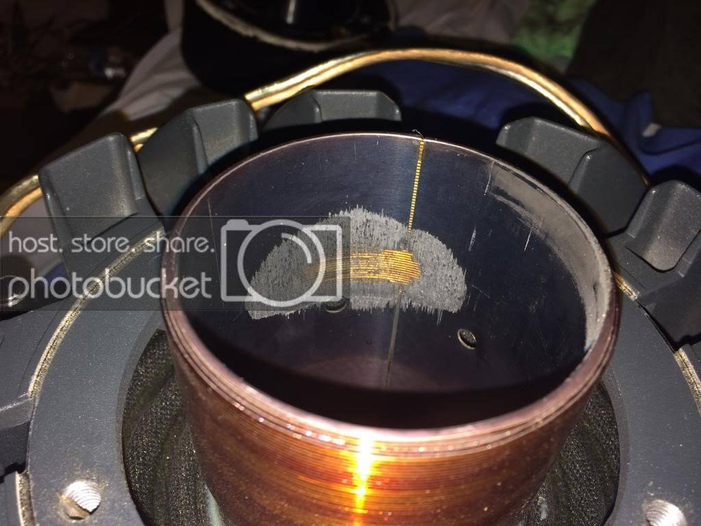

Also, when I push down on one side, it makes a scraping noise like it's rubbing on something.. but if I push on the other side it doesn't make the noise. When I tap on it it makes a "thud" noise, instead of a drum noise. I posted a video below:
Those tops are removable, take it off and have a look for evidence of rub and make adjustments in the opposite direction when you reassemble.
Does it look bad?
Before I took it apart, I noticed the 3 screws in the back were a little loose... Maybe a problem with the "thud" noise when I would tap on it.
After I took it apart, rotated it, and tightened the 3 bolts it still has the rubbing noise. Also when I tap on it, it still doesn't sound like when you tap on a normal subwoofer, it doesn't go down much freely when you lightly press down on the center either.. Are the bolts too tight?
