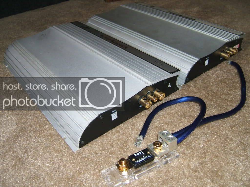

Yeah, they are kind of Off but I have seen some people pull some serious current threw not a lot of fusing
Heres an example of a way I've seen MECA fusing done before:
