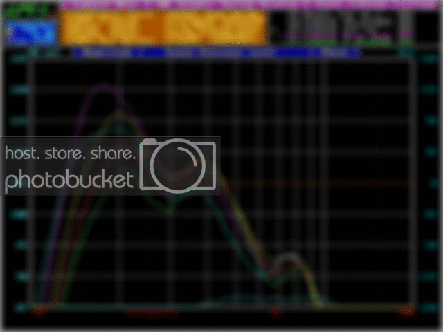

Here you go. I don't have any background info on what standard was used as far as driver/enclosure but I trust John's abilities and it's been pretty useful to me. To my understanding, the green line represents all windows up.
Vehicle is a 2005 Camry SE.
