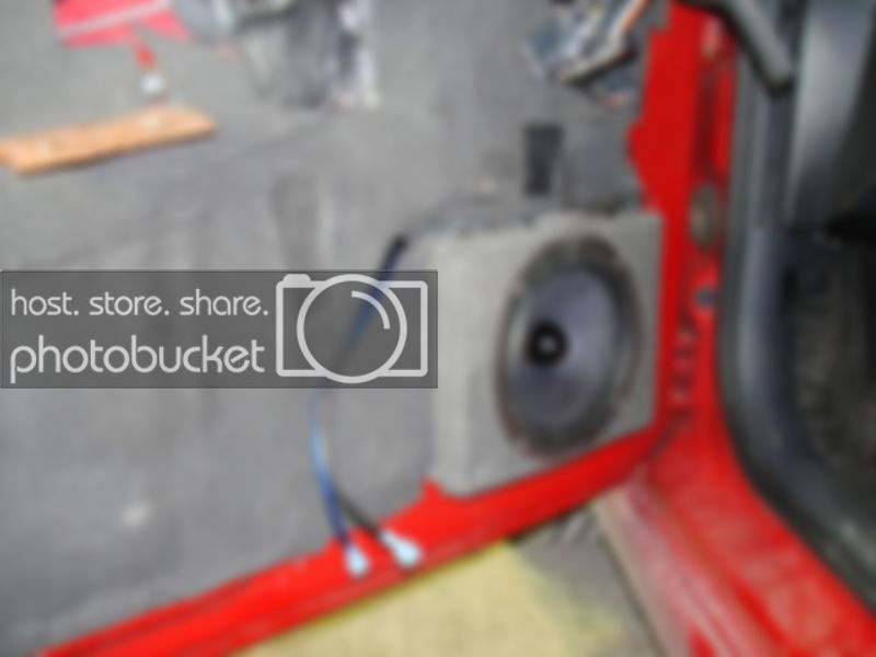

Am I applying this to the frame, teh plastic that protects from water behind the door or both?
when you say plastic do you mean this?
if so trash that and replace with deadener and foam(ensolite)
do something like this
