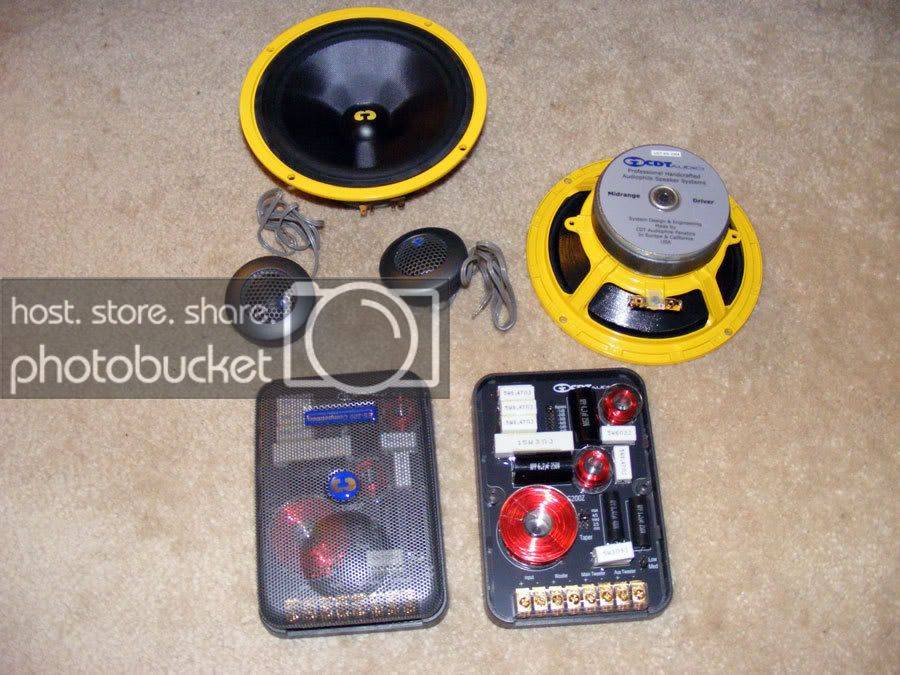

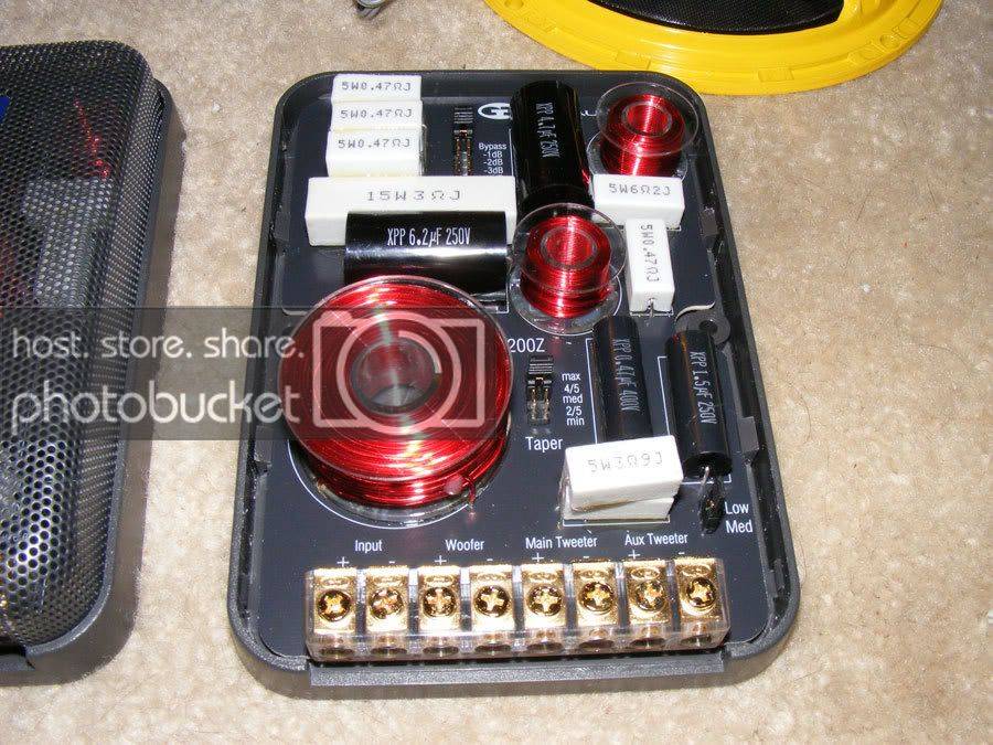

The CDT's
The CDT x-over

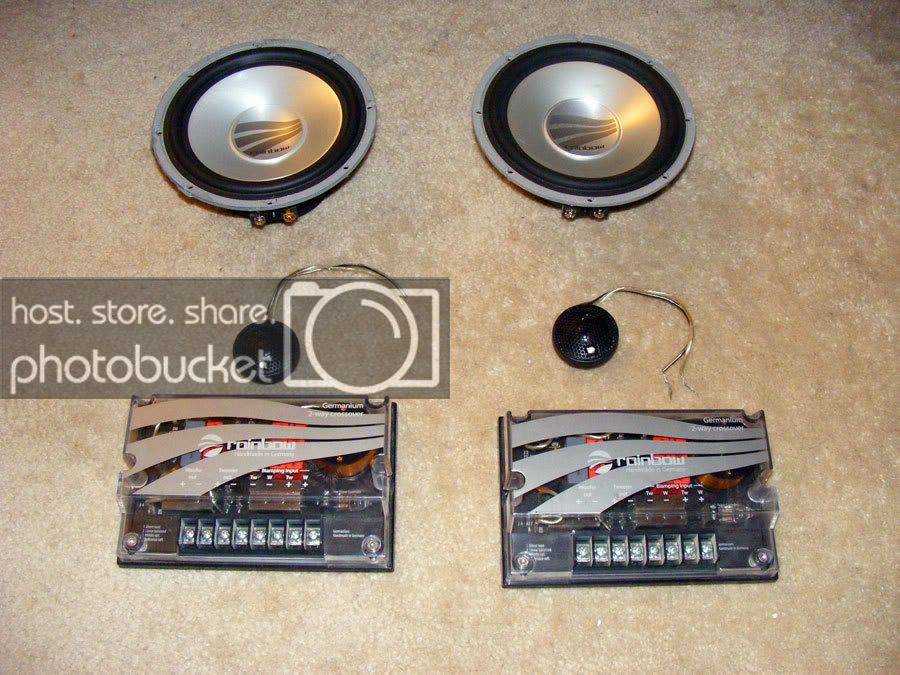

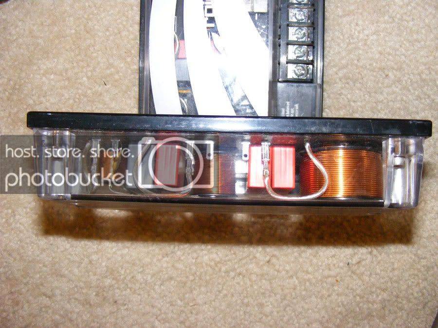

Germanium
Germanium x-over

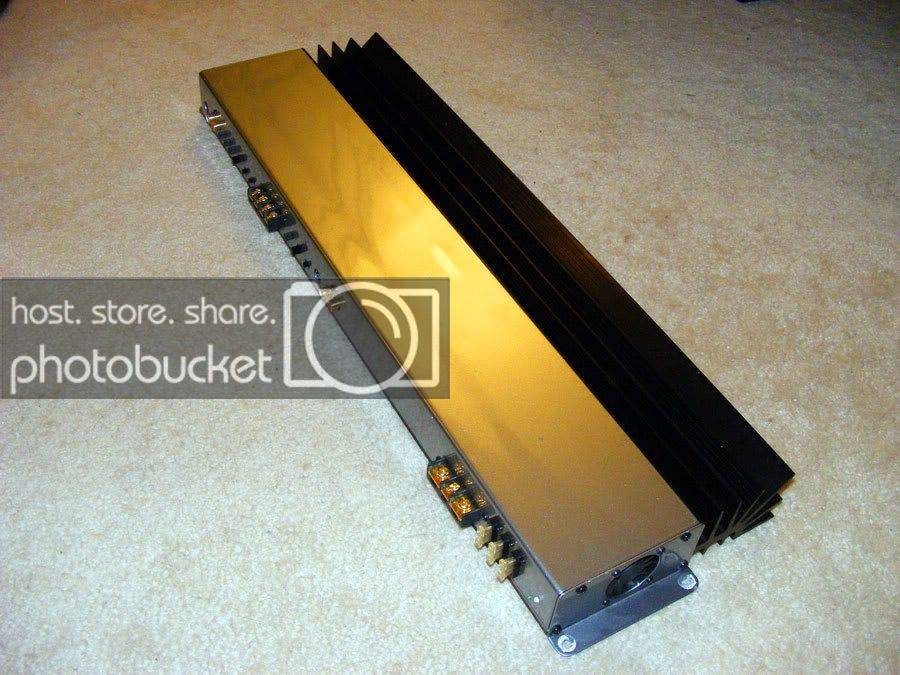

ZAPCO BABY!!!

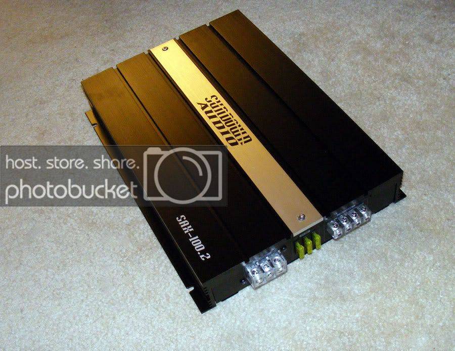

Sundown

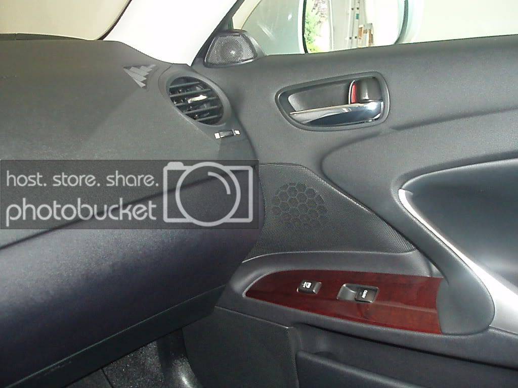

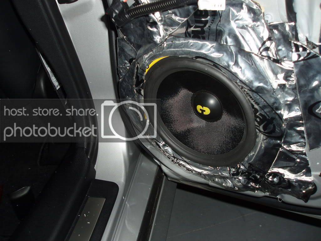

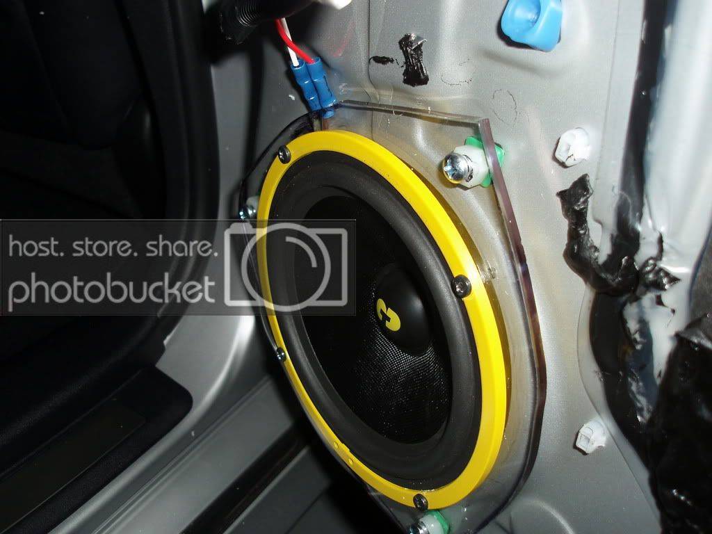

I just bought a pr. of es 600's for my back fill, I'm installing tomorrow. If I remember I'll post update tomorrow. Only the 6.5" mids are in the back, the 2nd set of tweets are in stock pods in an Is250. So it's only kinda rear fill.
i would grab the CDT better lowend extension and much more depth.. the Gs sound too airy and lite, almost thin...
This is what I found today when I installed my es600 mids. ( I assume they're the same as yours since they look identical) The cdt's are set @ 60hz and seem happy, while my alpine spx17's are up @ 80+. The alpines will bottom out set any lower. Of course the gains on the alps are set higher also, the cdt's are in the rear for fill. They do blend nicely with the sub.
