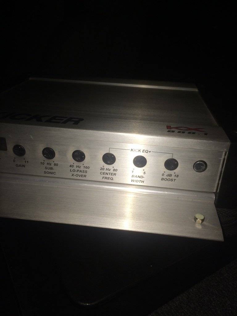

Its a single cab truck, space is very limited. Got 2 12' CVR kickers to fit behind the seats, of course there sealed. And I have a kx 800.1 mono amp. I set up the Gain using the ohms law, but still have yet to dial in my stereo and my amp.

Whats your low pass crossover set at? Does the 800.1 have a subsonic filter?
Yes, it does.. Thats what a shop set it too.. But sounds ******.. He was fast on selling me on a Epicenter so his settings to me are to question
That's where the settings were lol... Gain maxed out subsonic filter set way to high no wonder it sounded like ***

Gain is maxed the hell out. So subs are probably seeing a ton of distortion
Sub Sonic is set to 80z. Its a sealed enclosure. Should be at 10z.
LoPass isn't too bad. In a sealed enclosure I would be around 125.
EQ Center Freq is set to 80z. Again sealed enclosure, no need for it to be set so high.
Bass Boost MAXED. Distortion, Distortion, Distortion

Your post was just what I needed..
Got the Gain all set up..
The subs sound great, thru out the songs nice deep and tight.. Just beautiful.. Now the voice speakers are the ones that need some tuning not much but some..

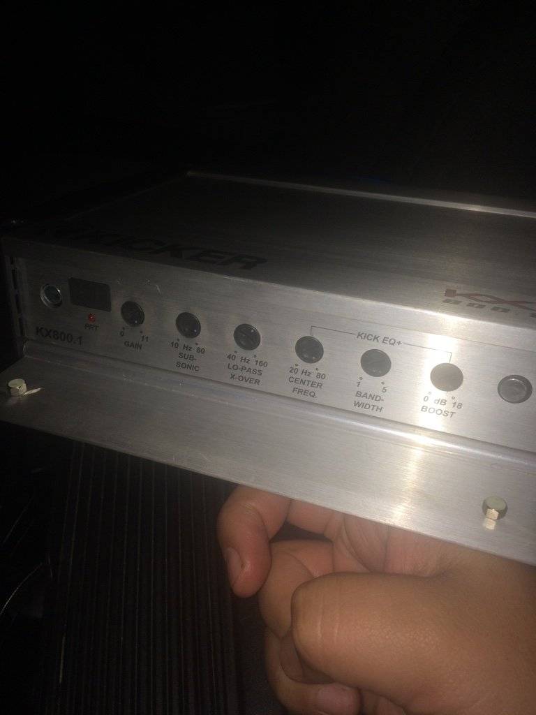

Here's how my amp settings look currently
Yes, on the truck.
At 0? I don't think Id be able to hear the subs at 0 tbh
I thought that too but with HU setting right and the gains set right you will be able too. Where in Social are you
