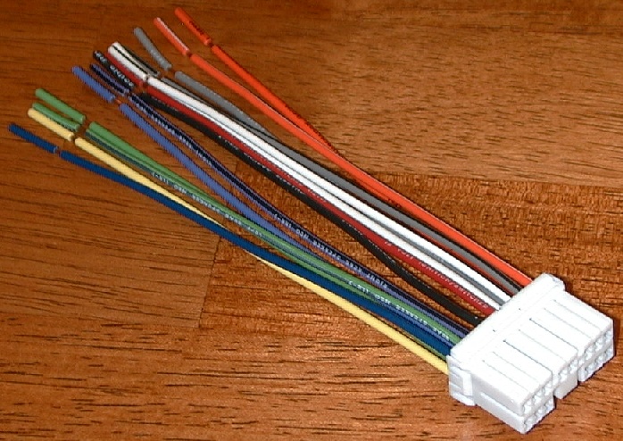

Something like this:
i just had a quick look, and im presuming a harness is the cables and the white block, so:
at the back of the radio there is a connector, where i plugged in a bunch of cables that were in the box with the radio, this then splits into 2, one has 5 cables (one red and one yellow) that i connected to a cable that ws already there, and the 2 bunch of cables i did the same but didnt take much notice of them.
I have know idea how i can pull them out of the "block" thing, i gave a pull but they dont wwant to give.
hope this gives somebody some extra info that could eventually help me
thanks
i just had a quick look, and im presuming a harness is the cables and the white block, so:at the back of the radio there is a connector, where i plugged in a bunch of cables that were in the box with the radio, this then splits into 2, one has 5 cables (one red and one yellow) that i connected to a cable that ws already there, and the 2 bunch of cables i did the same but didnt take much notice of them.
thanks
The red and yellow being connected to the same wire is your problem. Do you have access to a multi meter to check for voltage? The wire you have them both connected to is probably a switched power wire (only on when your key is on). That is the wire that turns your radio on. The yellow wire should go to a constant 12V source, it is what provides power to your deck to store settings and time.

It should be there, but I don't know exactly what's gone on behind your dash, so it may no longer be there(although I'm sure there's a constant source somewhere nearby that is usable in the ignition harness. Worse comes to worse, run the yellow wire all the way to the positive terminal on your battery.
You should have just been able to match the colors on the two harnesses and plugged it in without issue.
