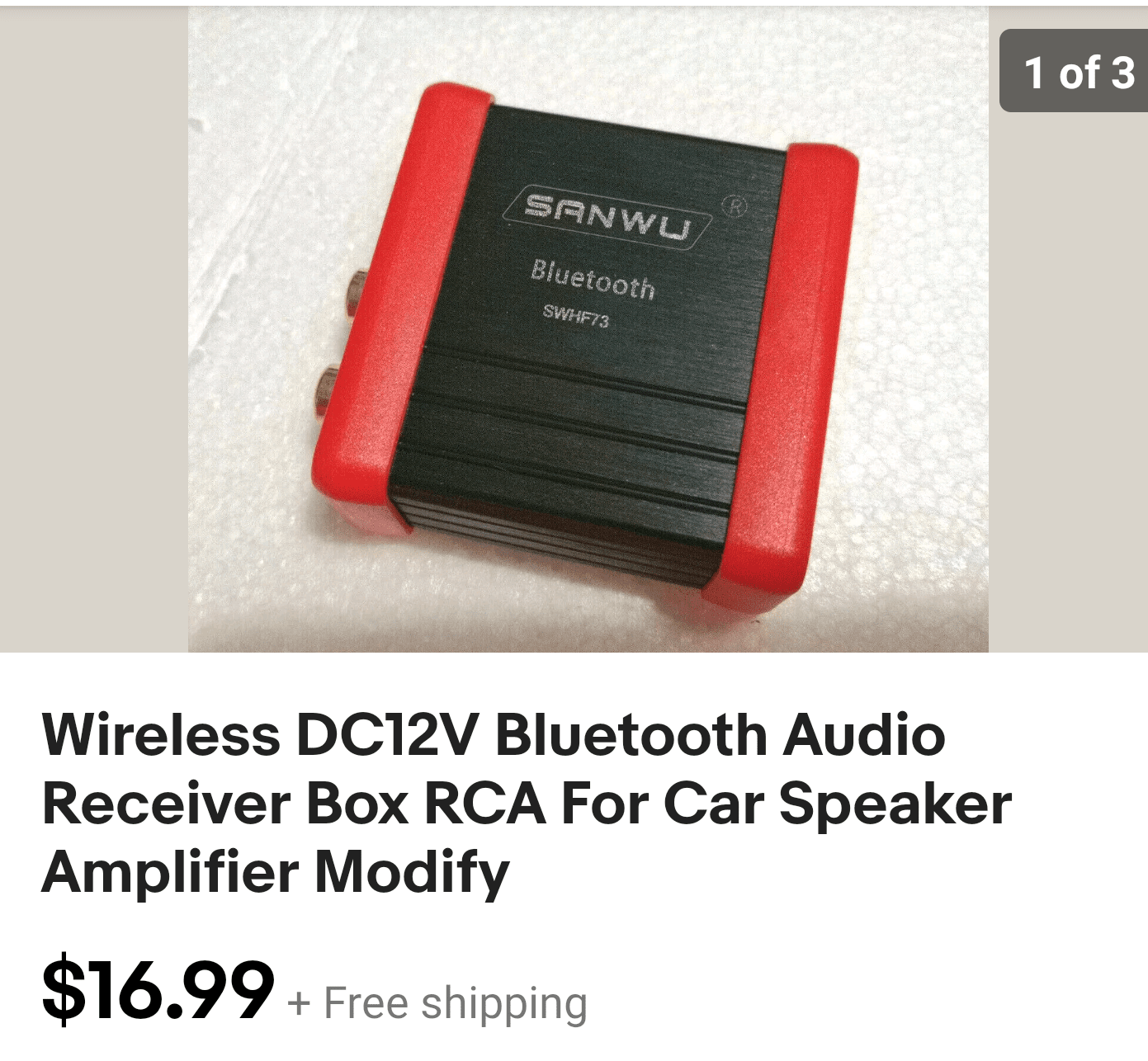

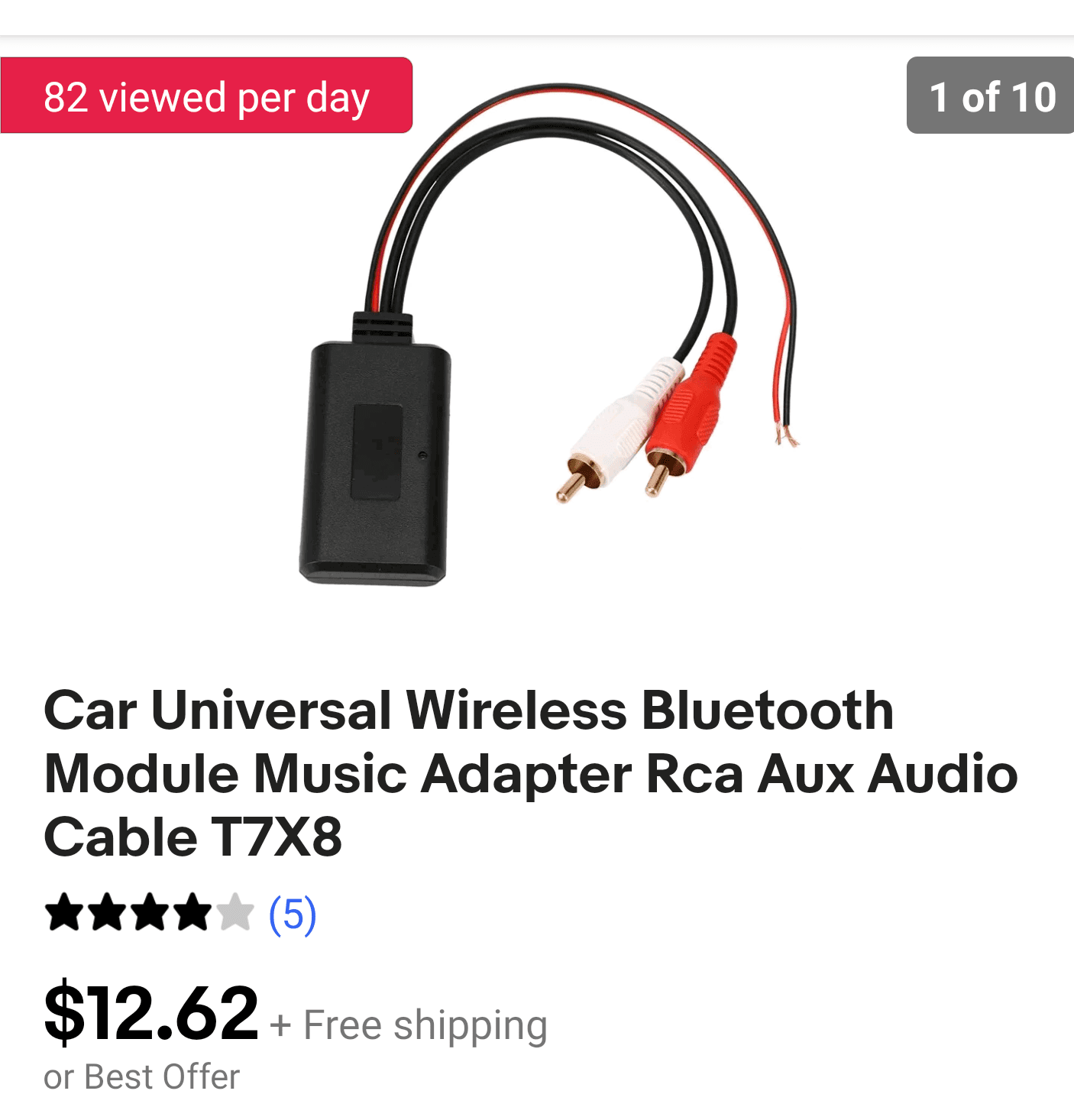

Another mode I want to try is a cheap 12v bluetooth dongle connected directly on the amp. Connecting it with my phone or a tablet is the plan that others have used. Some even integrated the ipad in lieu if the headunit. I don't want to go that far, but a stand or clamp of sorts would suffice.
Yes this will work, but volume control would be from the Bluetooth device
