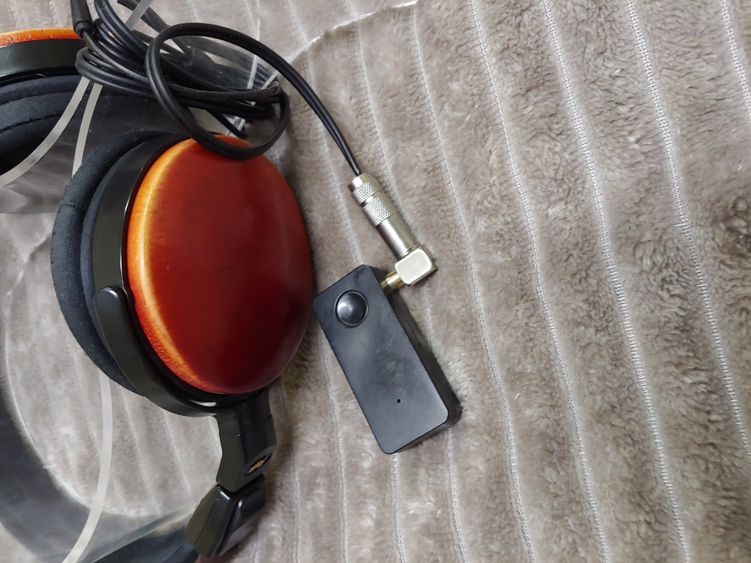

Like squirrel! said, it is a master volume. It will definitely control the volume to your amps. Volume has to go from the phone, through the rocker, then the amp. Have you ever used a bluetooth dongle? Same exact feature. A bluetooth dongle will power a set of regular headphones for a long time. So yes, it has built in preamp.

Aww snap! I totally get it now. In that case, the remote knobs that the amp has, totally control the full volume of said amp. But fyi, those units you were scrutinizing, will provide the same signal to an amp that a headunit will.
Yes but they would be limited to the max volume of the phone, Unless from what I understand they then have a pre-amp built in to increase the volume?
So for example, I connected one of those bluetooth modules to my home hifi amp, the volume control on the bluetooth maxed out the volume of the phone but the sound output of the speakers were very low. If I was to set the Hifi amps volume on max and then control the volume from just the Bluetooth module then it would give me full play of the volume of the hifi but controlled from the bluetooth module.
From this I understand that in the car scenario, I would need to set the master volume of the amp to max preferably with a master remote knob and then never touch it. Then just use the volume buttons of those rocker switch modules to have the control of the amps full volume control
