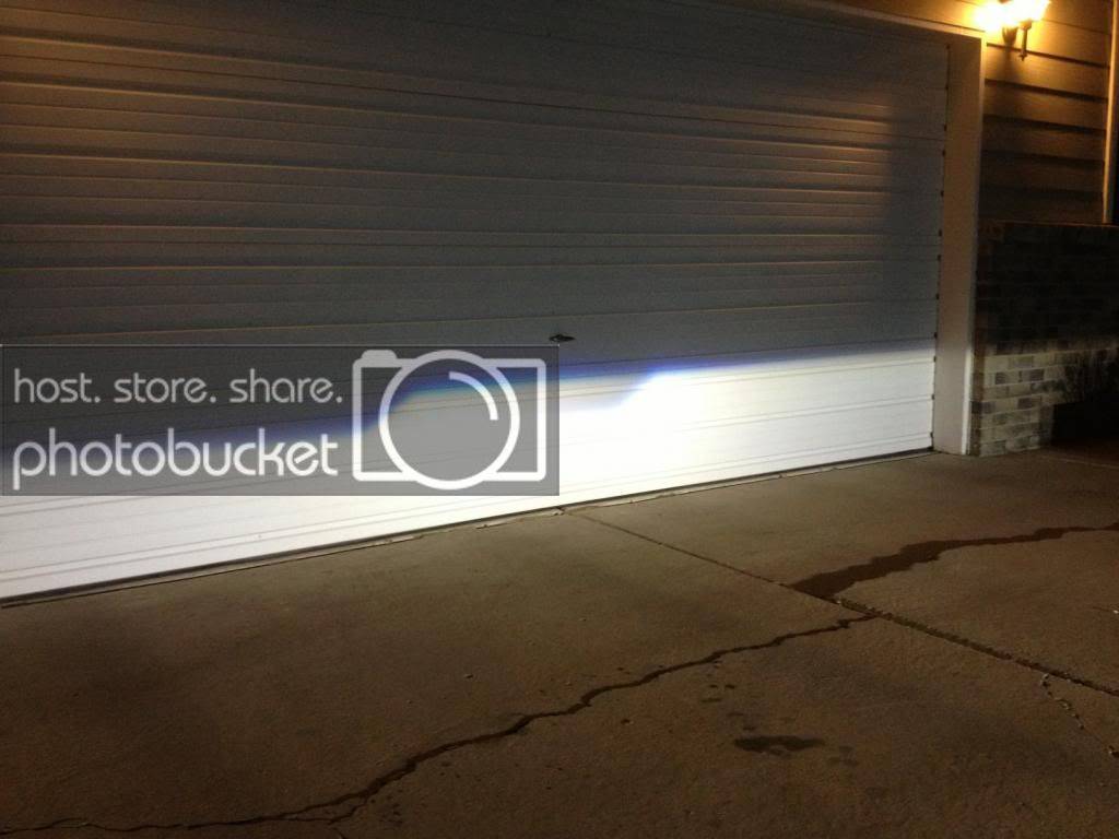

if i was going to do HID, i would get an entirely new headlight assembly, housing and all.
as an EE and lighting designer, i know that in order to get optimal light output, you need optics specifically designed for the lamp location and type.
