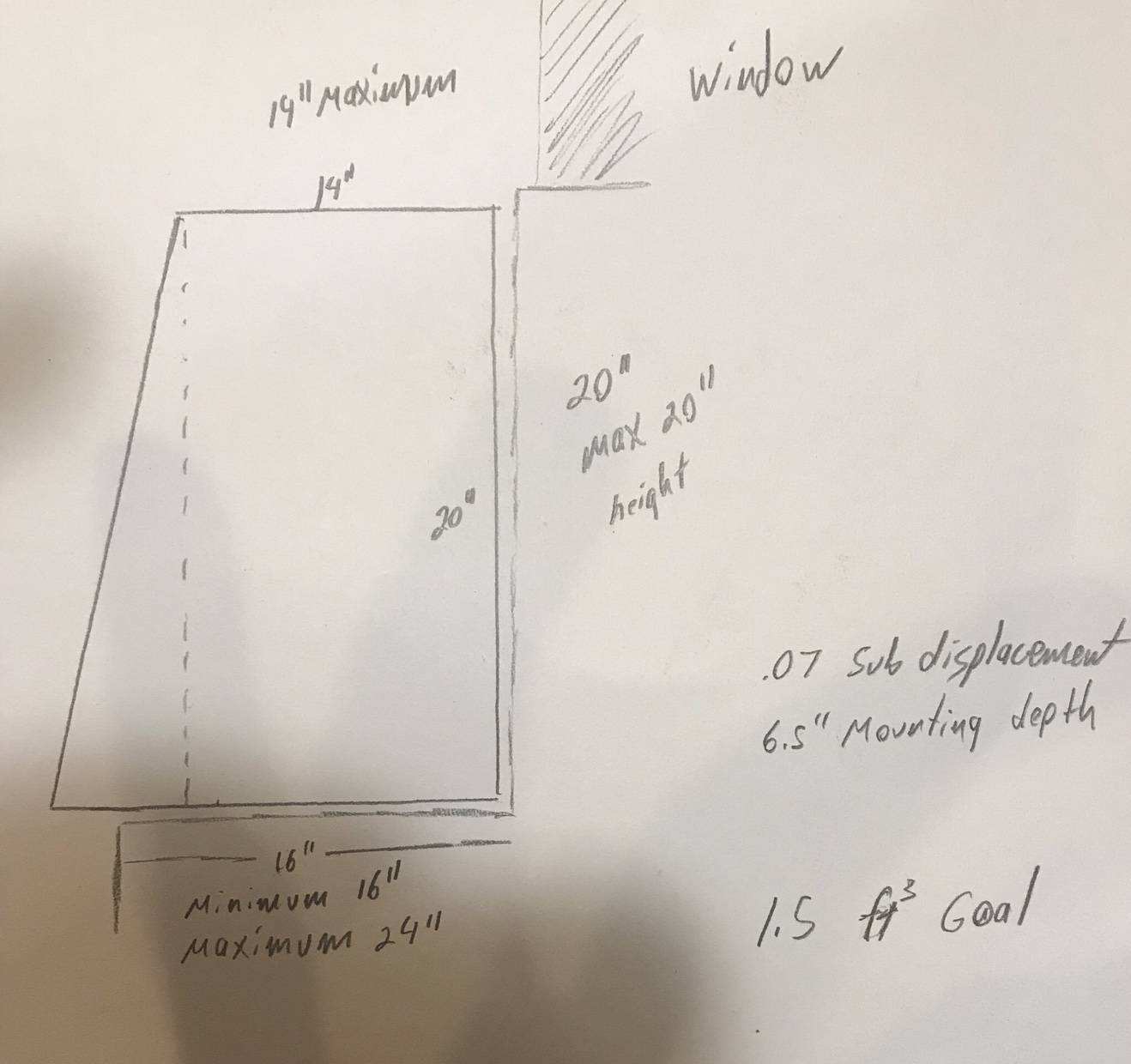

I’m trying to build a box to fit in my daughters Tacoma Access Cab. I was hoping someone could help me out.
I’m attaching a photo of some basic drawings/measurements that line it out.
Goals. 1.5 cf ported box tuned to 35hz. It will be a Soundqubed HDS310 pushed by 1500 Watts rms.
I want the sub to face the front of the cab, and I’m thinking porting towards roof, but I’m open to suggestions
I don’t know enough about porting and wanted someone to line me out on what you would put internally to give the best sound.

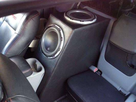

I’ve attached a box that I’m trying roughly to follow
Im not a sub box builder though I have built with specs, and recommended enclosure specs.I know to save room an Aero-port may be something to look into, that may work better for your case and be alot easier to build to save room and get it tuned properly for that space?Im sure that someone with more enclosure building can correct me and give more input
