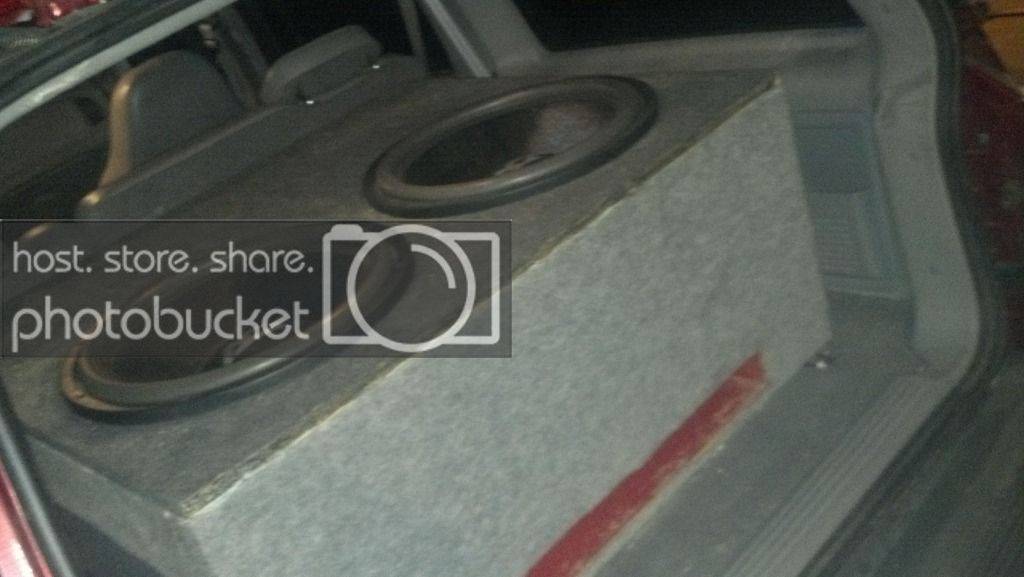

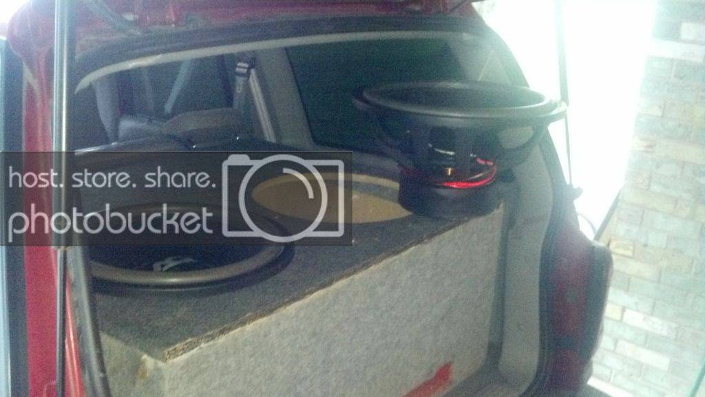

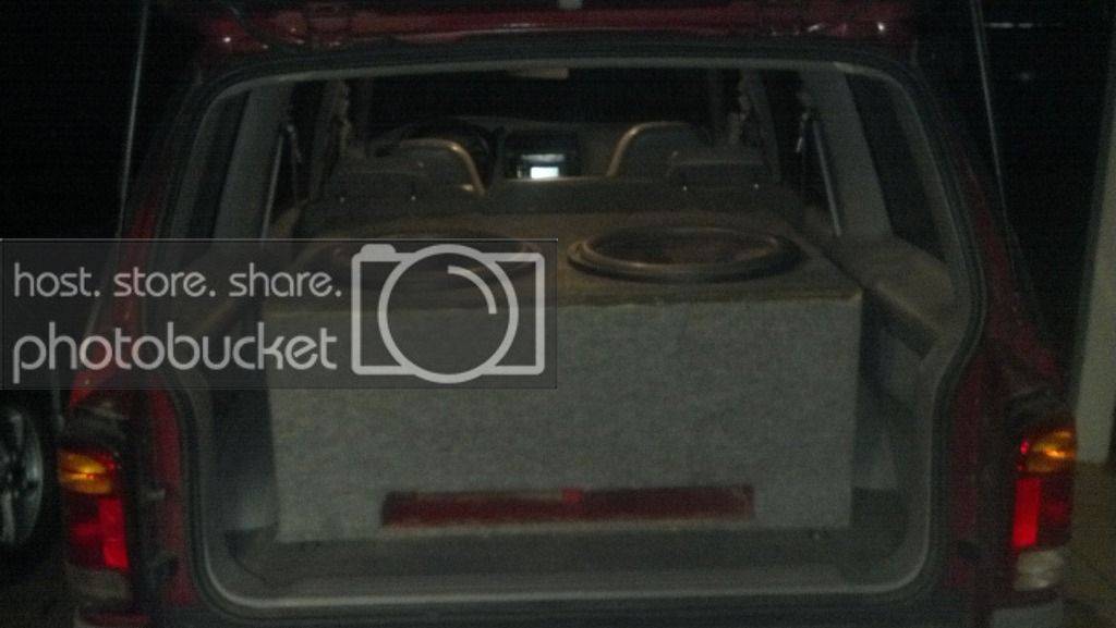

I've got a 2000 exploder with 2 hdc3 18s.
ok i have a blazer so its a difference in size of space. but ill say this my box is 7.5 cubes after sub displacement. i first tested my hdc3 with the aero ports firing externaly and got a base meter reading. then i started puting stuff in the box to bring down the size of box. so i started with adding 1, 2 liter bottle and my score improved. i think we got up to 3 2-liters before my score started to decrease again. and our math may have been alil wrong but we got down to about 6.5 or 6.6 cubes if not mistakin. so with that being said the best numbers came around there. so your easily looking a a 12cube min box honestly
In explorers best numbers setup with 2 18 setups is sub Foward port up slid all the way back to hatch. I did 155.4 with 2 18s sub up port back, flipped the box to sub Foward port up and bam 156.0.
