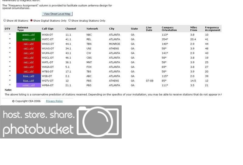

Now that I have some extra cash, I want to get an HD antenna.
My tv has a built in tuner, and Im a complete noob when it comes to this kind of thing.
Here is what antennaweb.org had to say for me. I need advice on picking one, or if someone knows one that will work for me.

And I dont need a multi directional?
Get the biggest possible antenna system you can put up in your location and that you can afford. Indoor antennas are always a compromise, unless you live in a 20 story high-rise. A directional antenna on a sturdy rotator will pull in the strongest signals consistently, period. A good rule of thumb is that if it looks pretty, it probably isn't worth shit as an antenna //content.invisioncic.com/y282845/emoticons/biggrin.gif.d71a5d36fcbab170f2364c9f2e3946cb.gif
When you lose directionality, you also lose receive gain...a simple vertical whip antenna receives the same from all directions, but will have a lower signal strength than an array pointing at the same station.
Don't forget to buy good coax, losses at UHF can be substantial. High quality RG-6QS will get the job done.

go to radioshack and get the biggest UHF/VHF antenna they sell, it probably has dust on it. Old school...with fins that angle up like arrows, the whole bit. That will work. I work at a VHF TV station;) We have analog 8|DT 9|8.1,8.2,8.3
You can also call WAGA and WSB, they'll tell you what works for them.
Ill have to look into that.
I mean Im 3 stories up in downtown Atlanta. There are a couple huge high rises, but I hear the signals bounce off.
Im going to try and get to radio shack very soon, or go to that site online and but a universal antenna.
